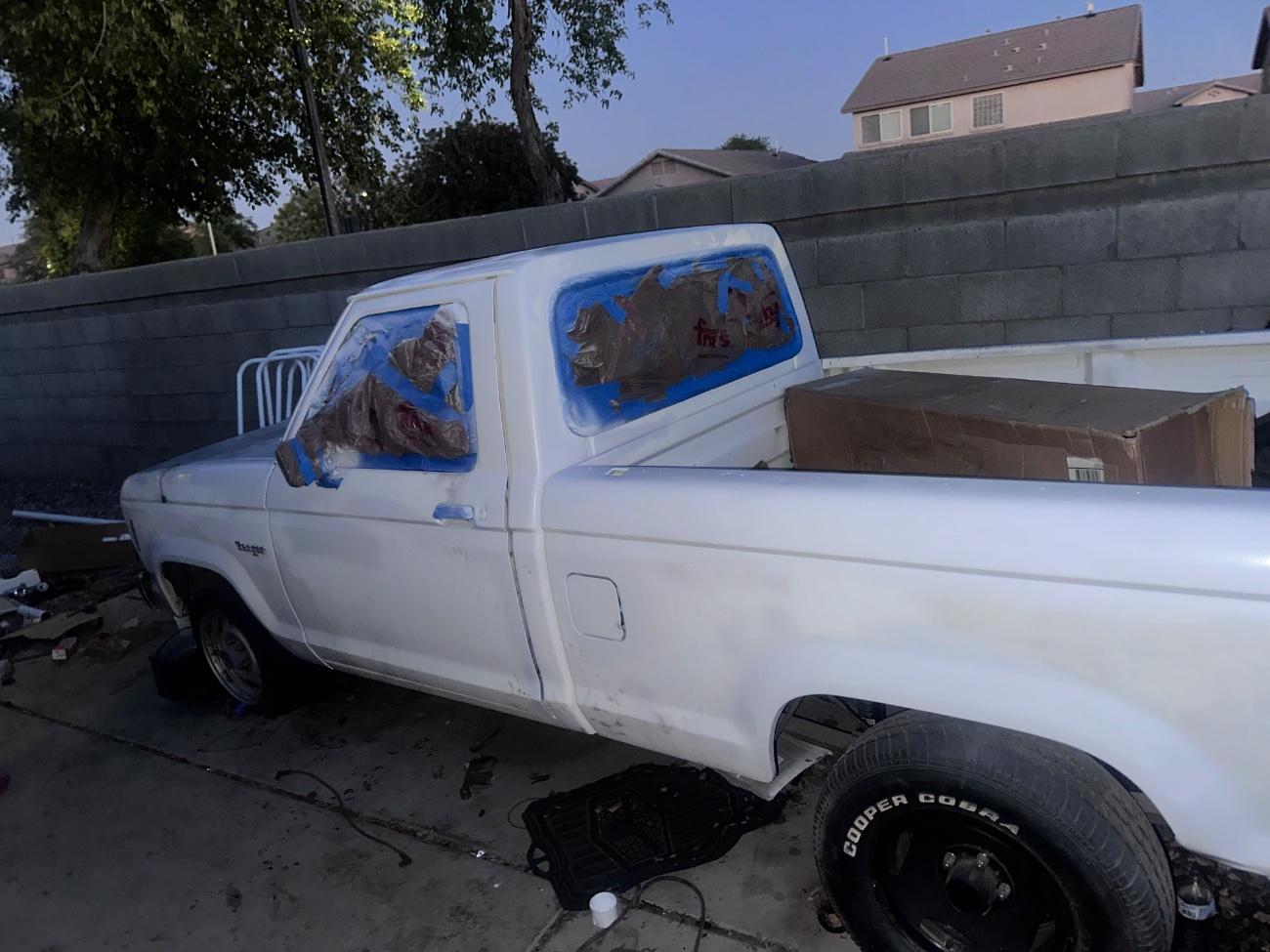

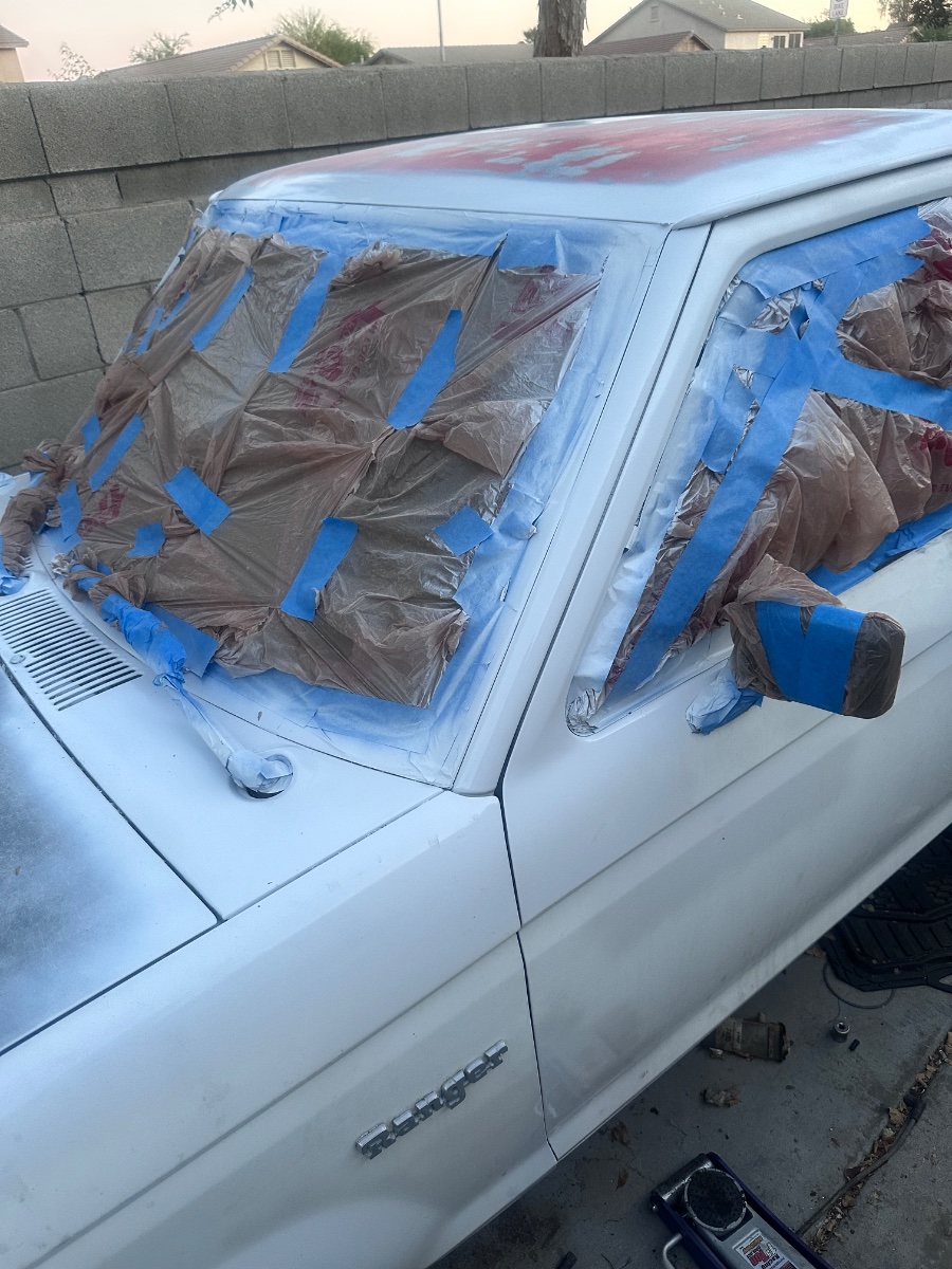

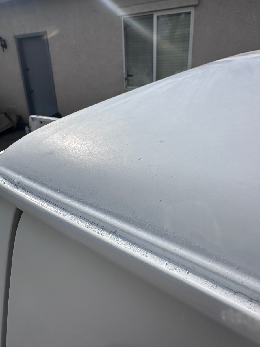

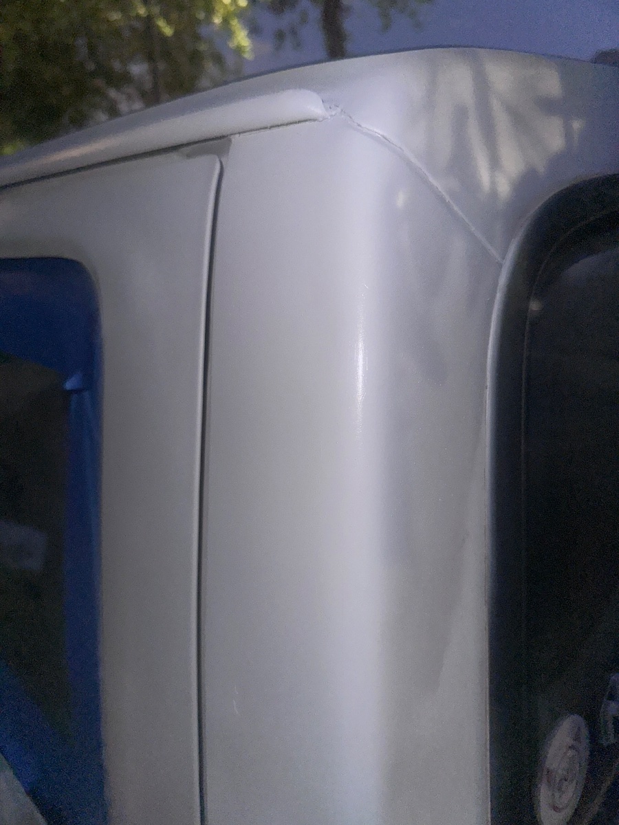

Doing some slight body work, and painting.
  • Painting the 1st gen
That's looking good!

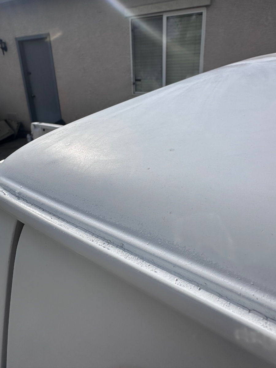

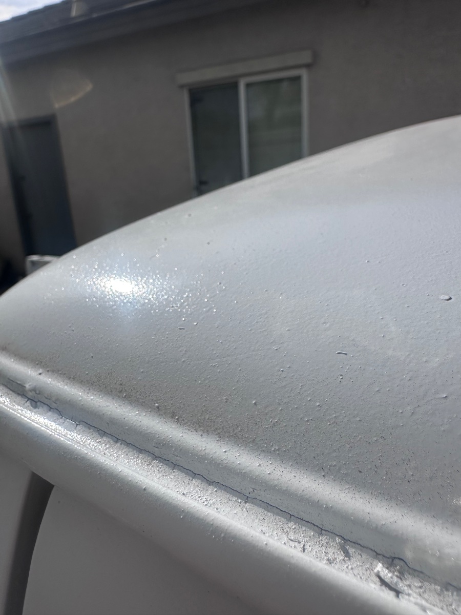

Thanks, its far from perfect but better then surface rust. Once base coat is down ill sand it smooth since im doing this outside and paint is contaminated. Might lay down some glossy clear but for now im just having fun. Gonna bondo the drill holes that were left over.
I would use JB Weld instead, since it's got metal in it.
I could but i always have trouble sanding it down, would have to use a low grit and cut into metal. i only want to lightly sand the basecoat so i think bondo should be okay

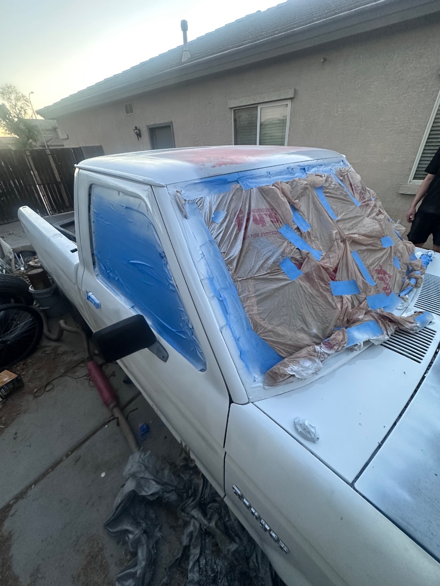

Bet, will update here in a week or few, like i said im half ass painting this, the proper way would be to sand down to the primer and hit it but im just doing a rough sand for the paint to lay on the existing coats, then run a clearcoat to lock it in.

I've painted a few vehicles with a compressor and single stage paint. I painted my F250 outside and it came out pretty decent. I even painted a Bronco II with oil-based Rust-Oleum in a paint gun that came out pretty nice. I know there are people that have painted cars with Rust-Oleum and a foam roller that has come out really nice.
I find it very rewarding painting my own vehicle and I worry less about damaging the paint when I know I don't have to pay someone else to fix it.
