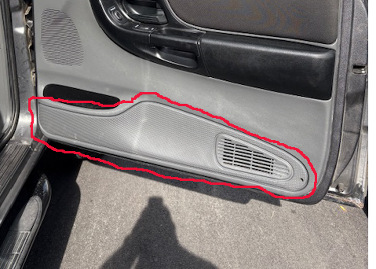

painting interior pieces
TSP is usually recommended to degrease something before painting.
Is that a screw hole at the end? You might be able to remove it, paint it, and reinstall it.
Your local part store should have basic colors of vinyl paint (dye), but if you want a better color selection, go to https://summitracing.com
Yes, it's a screw hole for the whole door panel. The panel is currently off while I'm redoing the audio system. You can see my progress here. I actually have some TPS from when we removed wallparer. I'll give that a try. Thanks!
Since you have the panel off, might look and see if there are clips on the backside. If it's not welded it should separate easily.
