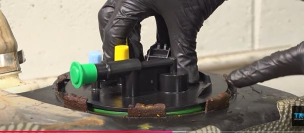

Being new to Fords and dealing with this issue for the firs time I started looking around yesterday hoping to see an obvious issue before I take the bed off again. Looking between the bed and the cab a portion of the fuel pump barely is visible. The gasket/o ring I put on is a green color and I noticed I could see part of it in that area between the top of the tank and the metal locking ring that holds the fuel pump down. I honestly cant remember when I took it apart how the fuel pump and gasket all fit together at the top of the tank. If the locking ring is not seated correctly cold that cause this code. I have watched a few youtube videos but can't really see any angles that show if the o ring is visible in spots or not.
I know when I put the lock ring on I had the fuel pump pushed down and made sure each slot was into place when I tapped it into position.
The fuel system has to be totally sealed, or it will fail. If you go to the station and fill the tank all the way to the top, and gas starts leaking out around the sending unit, then yes that is a problem.

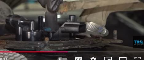

I found 1 youtube video that shows kind of what I am seeing. Based on it I think my locking ring is probably on correctly. I took a screen shot from his video with the pump in and pressed down and you can see the gasket between each of the tabs. Once he put the locking ring on the angle is a little from above so I am not sure if the gasket should be visible or not. I think I am going to try a smoke test before I take the bed off. I dont think it would be possible to miss one of these tabs and still get the locking ring tapped into place as rigid as they are.

Thanks for all the replies. I have found the problem. Based on the recommendation above I went ahead and filled it up with gas at the station a mile from my house. When I got home I could see the top of the tank was a little wet around the fuel pump, so there is an issue with the seal. I am guessing it is operator error on my part. Time to take the bed back off and see what is up. Not what I was hoping for but need to get the issue taken care of. At least it has all new bed bolts so that part won't be an issue.

Thank, on mine there is no plastic retaining ring. Just the metal lock ring like in the screenshot I posted above.

Finally got my issue fixed, unfortunately I had to get another fuel pump assembly. Once we got the bed back off today I found a nipple on top that one of the lines goes into had broken off somehow. Hot really sure how it happened but it was. Put another fuel pump on it and so far so good. I kind of looked and there really isn't any logical way that part of the bed broke it off when I was putting it back together last time. Also I had driven it for a week or two before the CEL came on. Either way, it appears as if it is fixed now.
