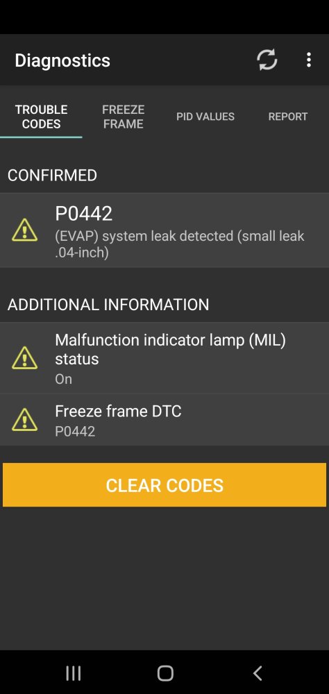

Well, same code I've been getting, but with different info with code. Problem still unresolved. Before the code said, "EVAP small leak detected", and nothing else. Screen shot shows the new info. Here is a list of what I have done since this started. Somethings I replaced due to age and it was maintenance time. Somethings I replaced because they're known to throw a P0442 code. Truck is a daily driver. I put about 100 miles a week on it.

EVAP codes generally don't cause running issues, P0422 "small leak", for sure won't cause running issues
And it's not a direct "vacuum leak"
The computer uses vacuum to put negative pressure in the gas tank, then closes all EVAP valves and watches the gas tank pressure sensor to see if it holds the negative pressure long enough to "pass the test"
If it holds pressure but not long enough then P0442 "small leak"
If it doesn't hold pressure at all then P0455 "big leak"
And this can be a computer issue, error in EVAP software
You can apply vacuum manually to Gas Tank and see if it holds negative pressure, if it does then bad pressure sensor or bad computer
If it slowly looses pressure then code is correct, there is a small leak, you can then apply less than 3psi positive pressure and see if you can hear the leak, more than 3psi can blow off EVAP fittings
