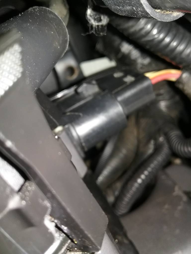

So I went out this morning to test the voltage. As I went to pull the harness off the CP, I noticed it was loose. On further inspection it looks like the clip on the wiring harness broke(I have a feeling the tech that replaced the VC gaskets broke it) I put a zip tie on one side of it best I could. I might put a zip tie on the other side? I cleared the codes and took it for a drive, it appears to be all set! Any other ideas how to solve this? Can I get a new clip for the harness? Should I put some dielectric grease inside the harness connection?

So i looked on Rockauto and they sell the MC coil connector harness for $13. I wonder if the zip ties are fine or should I get the connector?

I looked again and there's prob enough room to splice on the new connector. Maybe use solderless connectors and tape it up well.

I would get the connector as cheap and fast as possible, even at a junk yard or something, and then de-pin both and just switch the hard shell. It's not that hard to do and less troublesome to do than opening wires.

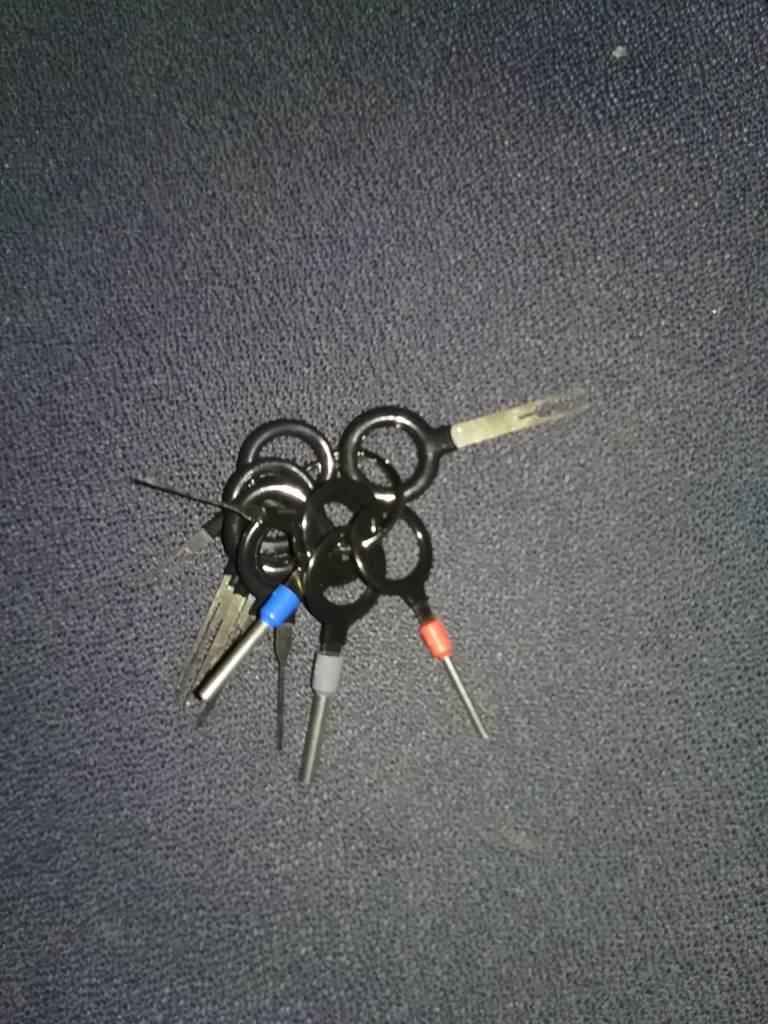

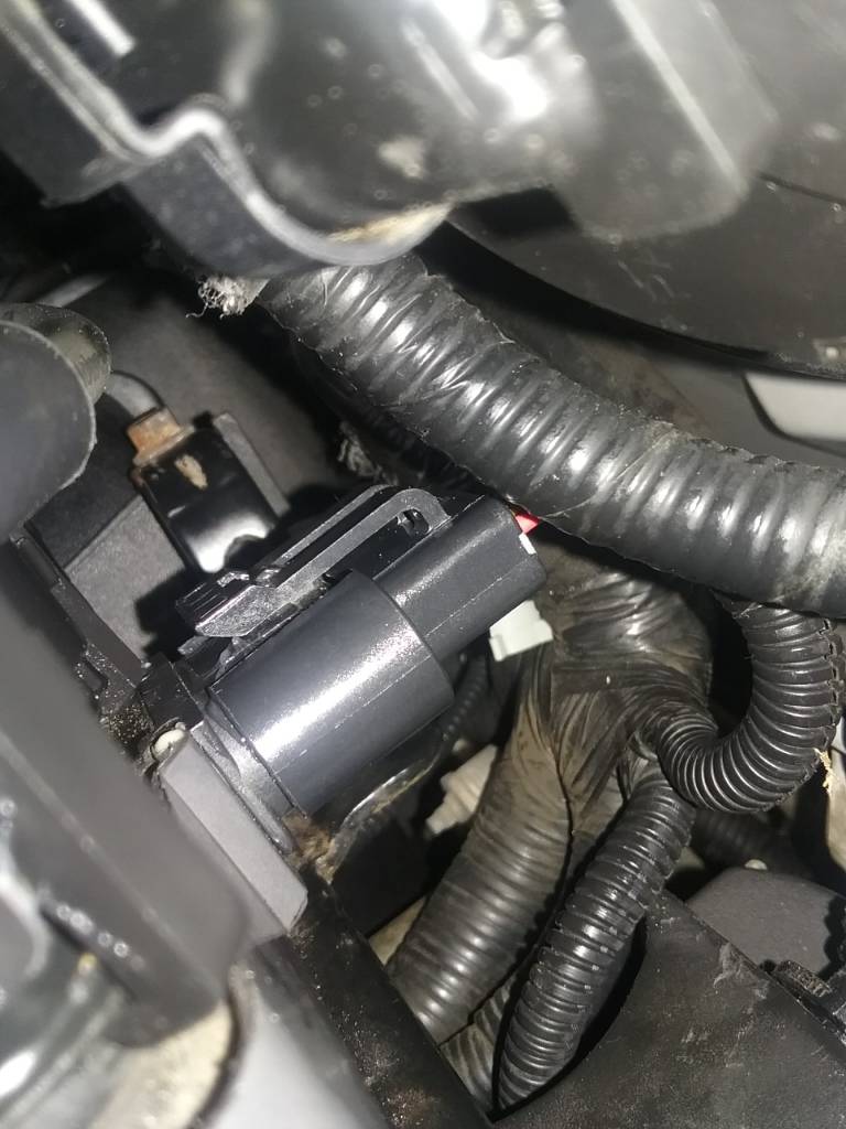

Mission accomplished! : my new connector from Rockauto showed up yesterday along with a $10 depin tool set from Amazon. I ended up just using the small screwdriver in the pic. I did not need the depin tool set. I watched a 5 min YouTube video of the process. I was unaware that you could even do this until Adsm08 told me you could. I spend about 30 minutes fiddling with the new connector until I figured out how to depin/remove the wires(I was watching Bones at the time and she does distract me) [emoji16]. Today i swaped the new shell with the broken one. It only took 15 minutes of actual work! It fired right up and so far so good! Thanks again Adsm08 you're the best!
