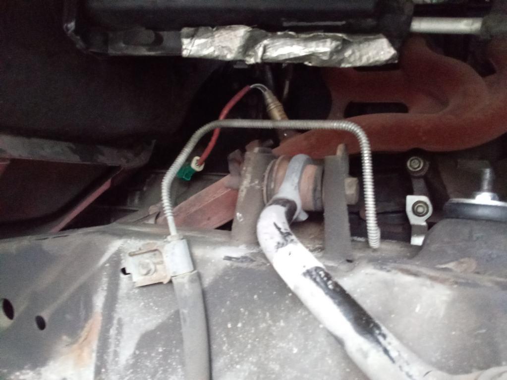

I removed the right front wheel and inner fender liner and it's a fairly easy straight horizontal access :
My brandy new Chinesium special sensor socket started to slip so I stopped and re grouped, used a large pair of Vise Grips to hold it from slipping and pushed with one hand and pulled with t'other :

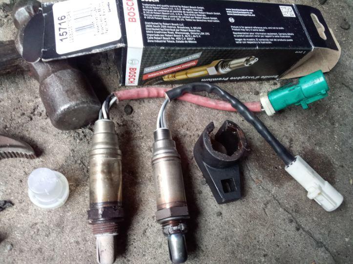

The sensor came right out and Lo ! look what the D.P.O. or D.P.M. did :
I dunno what they were thinking trying to turn the sensor with pliers or something .
You can also see where they mangled the hex area, probably trying to use an open end wrench .
New & old sensors :
