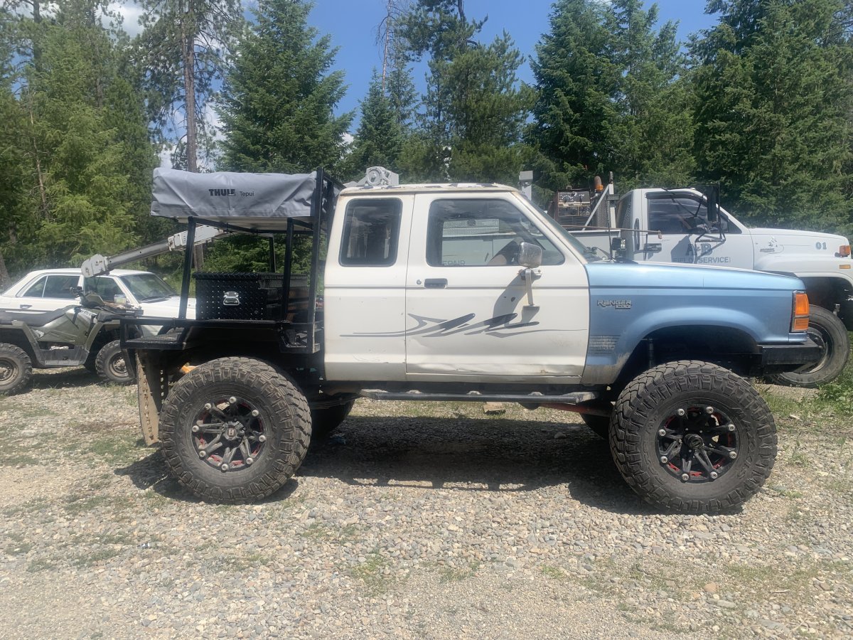

Well I bought a roof top tent for it. I am really limited on space. haha This is my start. I guess this has been my goal I've been moving to without knowing it. It was fun and I hope to do it more. My goal is to get the old B2 going again and set it up, Because I really don't have enough room in my stubby ranger but for the few nights I spent on it it worked. Having another rig with make it so the whole family could go. Need to figure out how to get a 12v fridge on it and water and a spare tire and really I think I'm golden. which I can mount water cans to my rack no issues, The fridge well I have a few ideas and the spare tire I have an idea on how to do that also. I love my ranger. You can do anything if you try hard enough.

Keep water tank as LOW as possible, off-road center of gravity is important
"A pint is a pound the world around"
8 pints in a gallon of water, so 8 pounds a gallon
10 gallon tank will be 80lbs on the side of a hill.....................so under the bed, and if you put it near exhaust you could have a warm shower when you park to camp, lol
thats the coolest flat bed ranger i have ever seen
I second Ron’s comment. Keep all weight as low as you can and if you must put things on the roof, the lighter the better. Especially with a lifted vehicle.
Especially if you are going with a commercially available rack for the roof. The max load rating they publish is for on road only. If they list an off road rating, it’s in the fine print and is 1/3 to 1/2 less than the on road rating. Many a person learned that lesson after their roof rack ripped off and ended up damaging to vehicle and the contents on the rack.

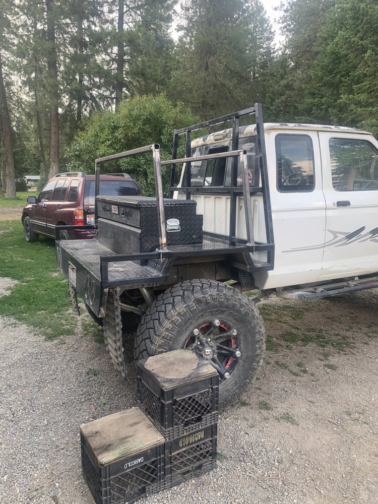

I'm also certain I would likely break my neck on those milk crate steps.
I'm still brain storming, but I don't want to haul a lot of water. Just maybe a couple of those couple 4 in PVC tubes that people do for custom water little water tanks. I just have no room under the bed. If I did I would of put my fuel cell under the bed. I put it in my black tool box. I built everything as low as I could and the shock mounts are pretty much where a tank would go. I want to put my doubler on at one point also so that takes up even more room.
I don't want a roof rack. This thing is already almost to high lol I can put a few things on my tent rack. Its built plenty good enough. 1.5 tubing, 3/16s thick. Its what I built my flat bed out of. Plenty strong enough. A fridge or full size cooler, needs to go on some how. I think If i put a smaller tool box or build a smaller one, I can side a cooler next to it. And my next Idea, for the spare tire is just to build a bolt on, rear tire mount. Kinda like a Bronco 2. I don't have any recovery points on the back. I was in a rush and just forgot to put any and I want to put a receiver hitch and I could build a swinging tire mount. Idk well see I'm still brain storming on it. Right now It sucks, because right now, there 4 of us in my family. My twin 2 year old boys and my wife. Car seats don't fit in the back of the ranger. lol I tried. haha hard no. So right now I took one out and left the other at home. With the bronco 2 going I could set that thing up with another tent and I could haul the kits in that and we would just go with two rigs. I don't need some time to think. Ive got the bronco in the shop now. Its just not going to be fast well. I just need my boys to get a little bigger so they can ride in the booster seats. Well see haha

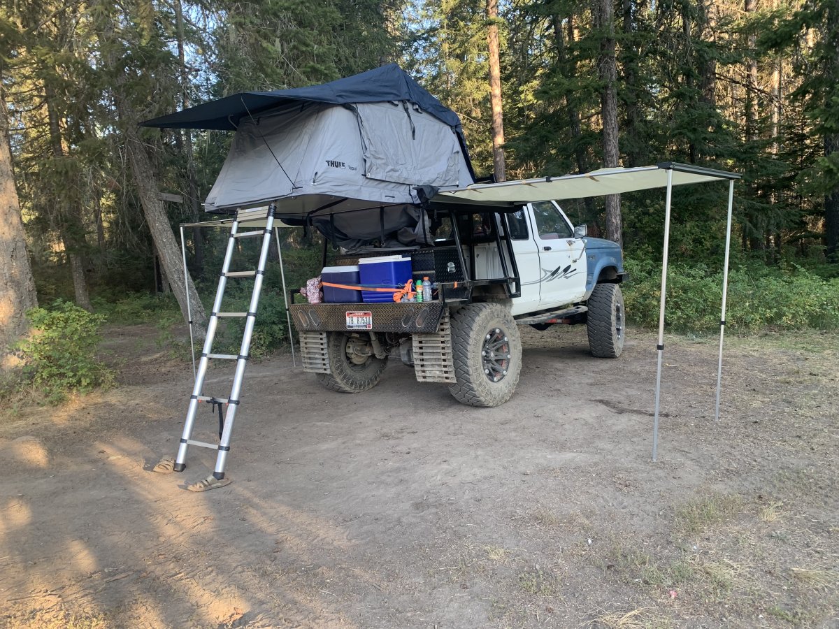

Added some canopies. Had to try them out so I did a quick one night trip. Its #3 night in the roof top tent. This time with the wife. I really couldn't really say anything negative about it. It nice to be off the ground. Still working on ideas on water and a 12v cooler. I'm just going to build tanks out of 4in or 6in PVC. Im not spending 150 bucks on tanks. I can build something that should work.

That's a sweet setup. It's a whole home away from home

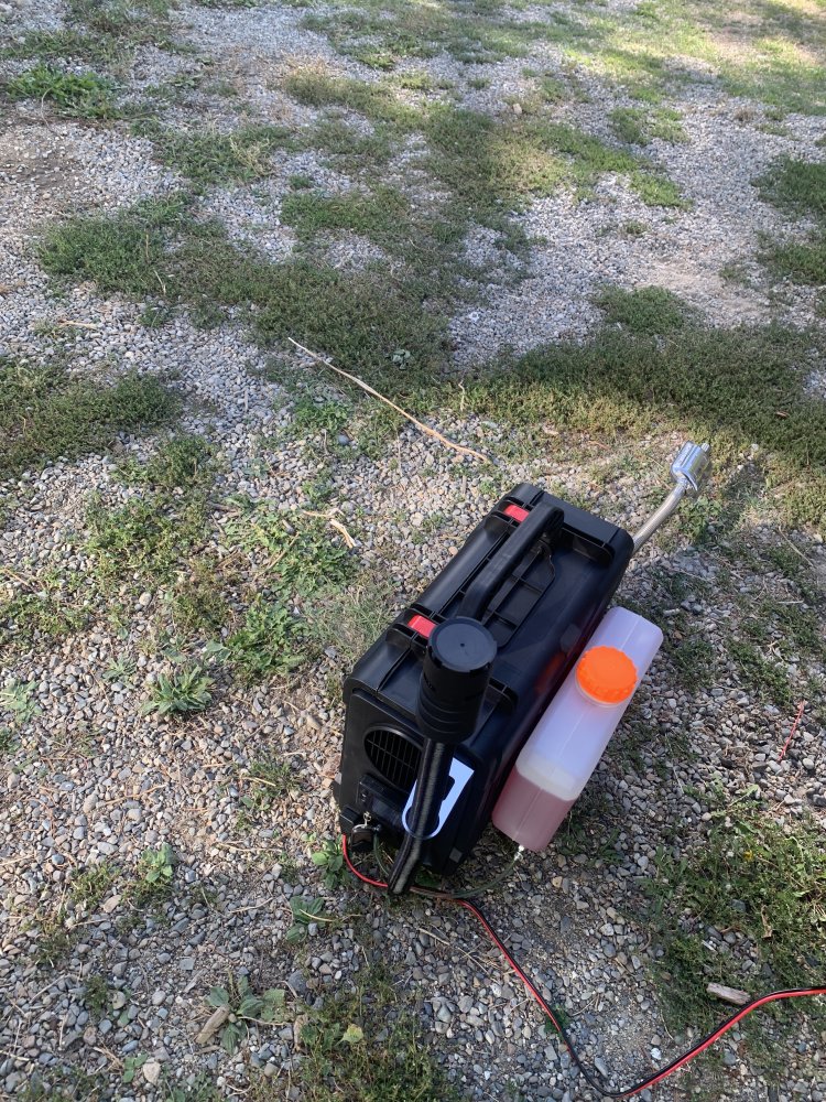

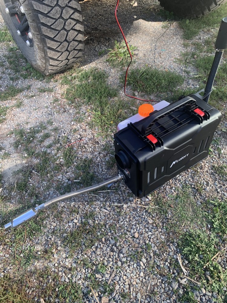

Got myself a diesel heater. It sits outside and you run ducking up to the tent. Should work really good really. Pretty happy with it. I have an overland event at the end of the month I'm taking the kiddos to so I really need heat for that. this should work good!
