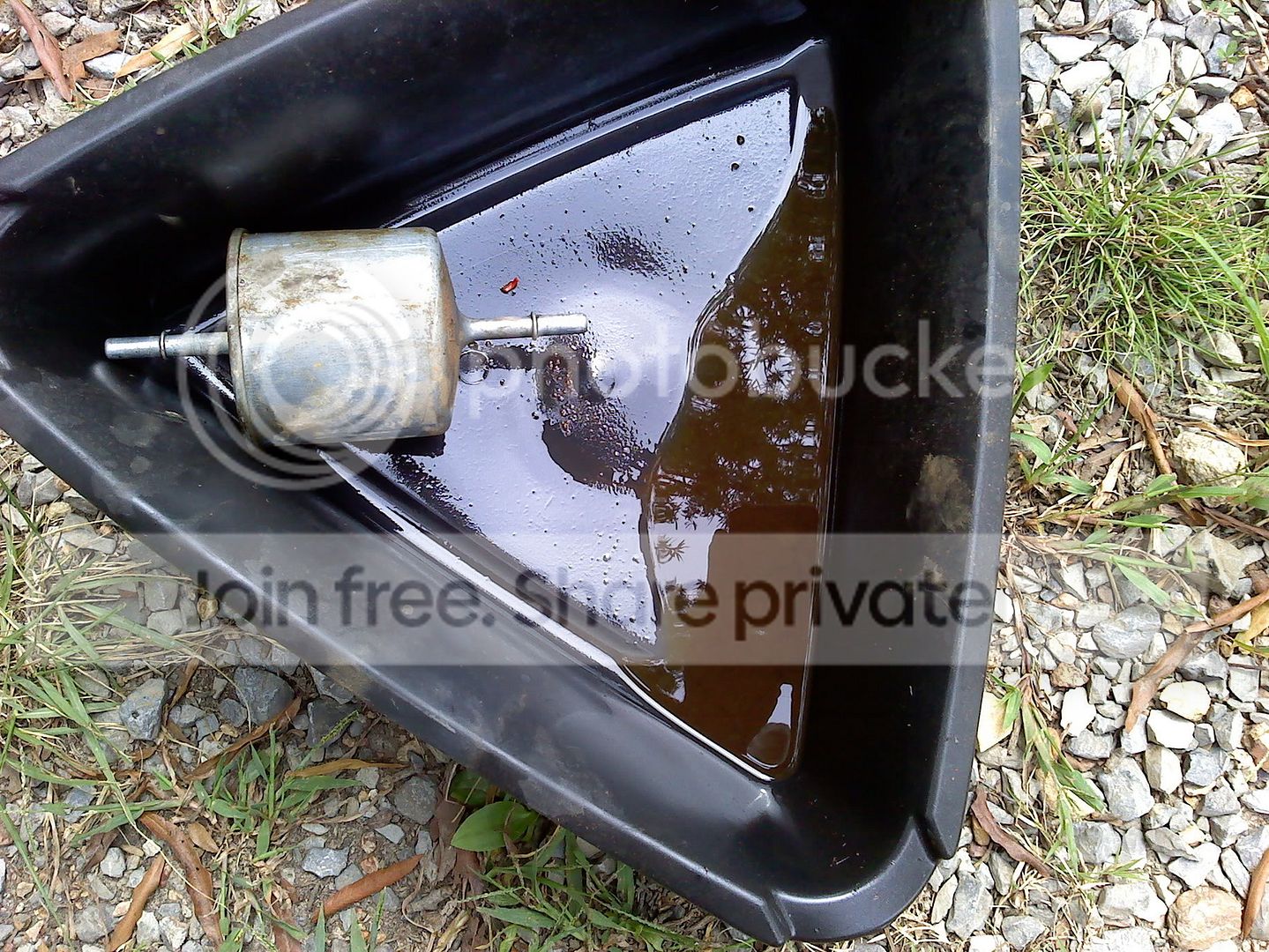

Here's what came out of the filter:
I was going to pan it and see if there is any gold in there LOL

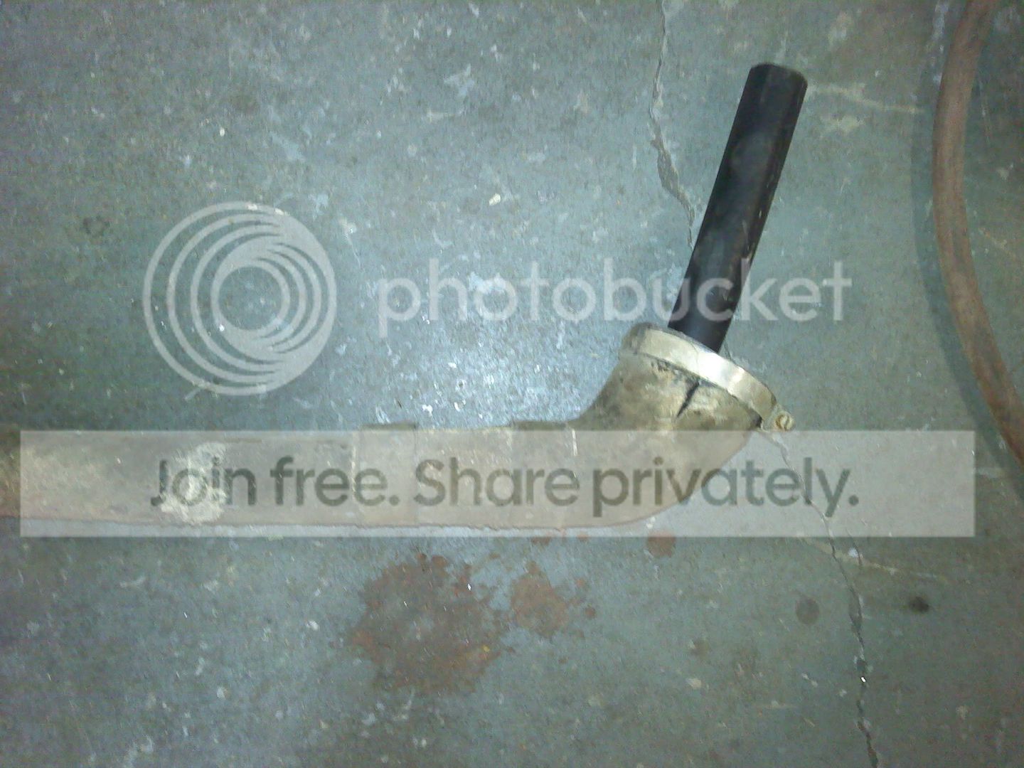

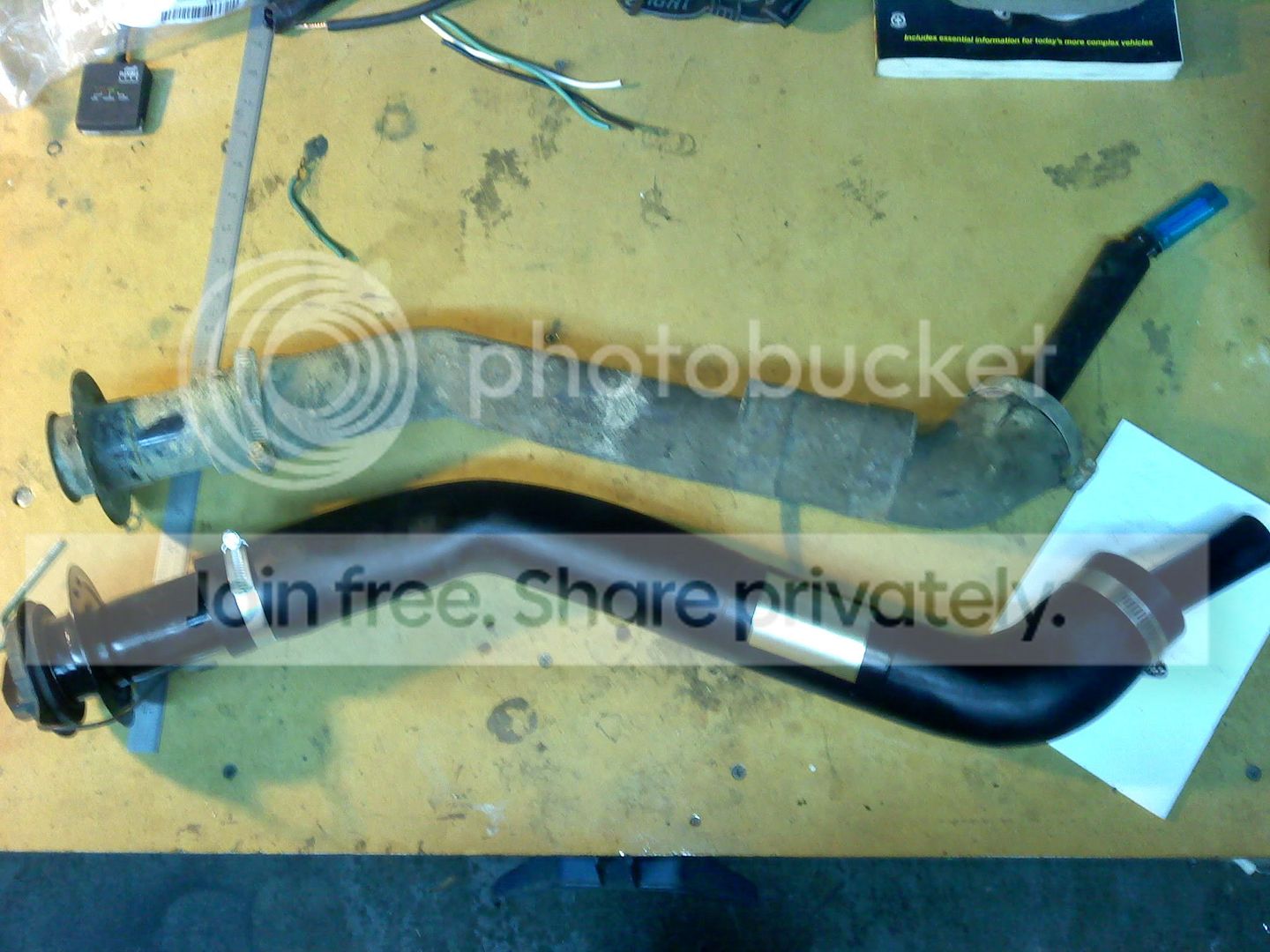

My filler neck. You know autozone wanted $185 for that?!? Its a rubber hose for crying out loud! I found one on ebay for $30 shipped.
I bought one of those filler necks 2 years ago and it rotted out in a year, but I live in Cali and have to use the special California blend. It might have something to do with it. At $30 a pop, it's not a huge deal, but sliding the bed off every 2 years before smog tests gets old.

dont recall you asking, but when certain drivabilty issues come up i suggest to do volume testing along with operating with a fp gauge under all load conditions.
when i buy a used car....unless its obviously brand new it gets all new fliters in everthing that has one...and i maintain it from there.
water infested fuel restricts the hp filters and stresses the pump(s) so annual changing is good practice.
i know fuel restriction is given many times for this issue on this forum especially with boost application.
i think your new filter will be short lived based on that pic.....and drive till its about out of gas and suggest dropping and cleaning the tank and replacing the in tank sock as well....
