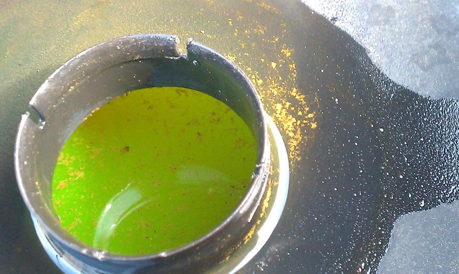

So, my radiator has recently started boiling over, but not overheating... I think. After the symptoms started, I replaced the thermostat and coolant temp sensor just to make sure it was working correctly.
-new thermostat and temp sensor
-new coolant
-when the engine gets up to normal operating temperature, the temp shoots to the middle of the gauge and then slowly goes back down to closer to the "Cold" side. I think this is when it boils over.
-top radiator hose gets very warm to the touch.
-radiator cap doesn't get hot at all. It is sometimes cool to the touch while the engine is running at normal temp.
-faint gassy smell in coolant. also some weird foamy grey substance (oil maybe)
Is this a double whammy situation of bad water pump AND head gasket leak? Anybody ever have these symptoms?

Sediment in the coolant is normal. Even with the best rust prevention chem's? It still happens inside the system. That's why we do flushes and refills on a schedule.
