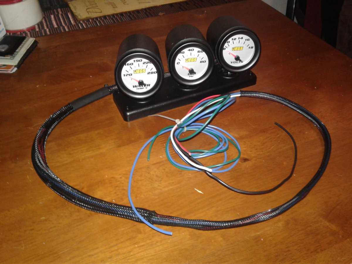

I bought gauges from Jegs... their house brand. I believe they're Stewart Warner.

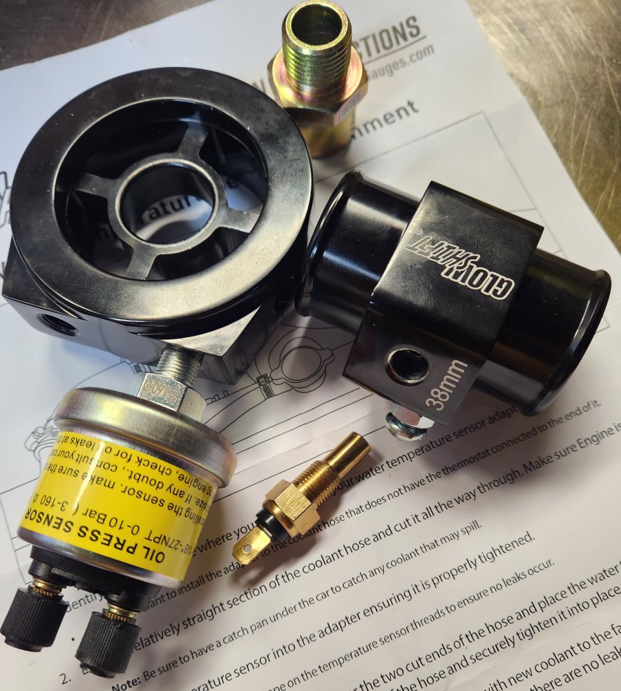

To leave your factory stuff in place and functional.... while adding aftermarket gauges... I chose a filter sandwich adaptor and a radiator hose inline adaptor to install the senders.

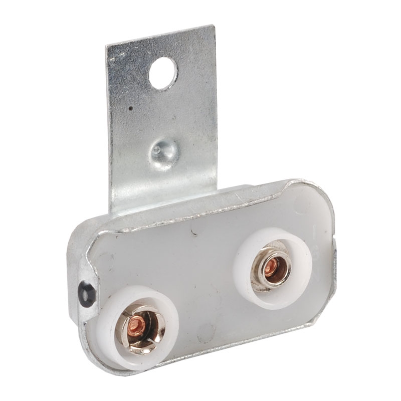

this particular setup has voltage regulator issues. i went through quite a few.
i run a gm setup now due to the style engine i have swapped and it has a similar issue with fuel slosh...
before i hacked in the gm gauges i went through a few regulators....its a 9v battery looking connector critter
