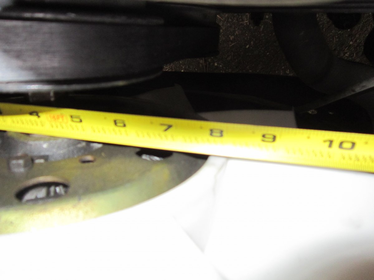

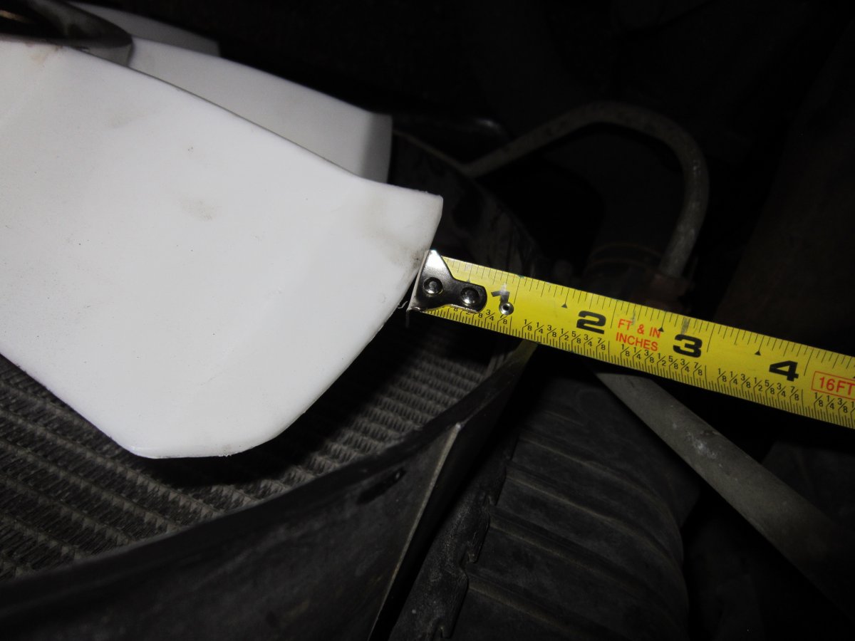

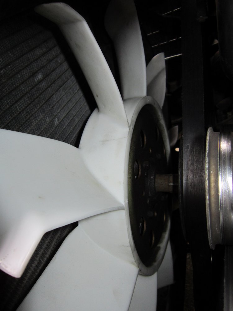

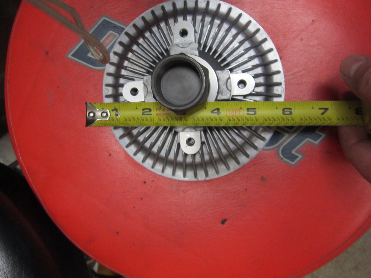

Ok, so I grabbed another beer, went outside, popped the hood, got wrenches out, went to put a wrench on the fan clutch and this thing is large. Larger than the one given to me. About 8" across. New one is about 6". I checked NAPA website with the part provided, says its for my vehicle and image matches what I received.
So I looked at the fan in the truck, there is about a 1" gap between the edge of the fan to the shroud. I always remember them being closer like 1/2" or less. Am I wrong about this?
