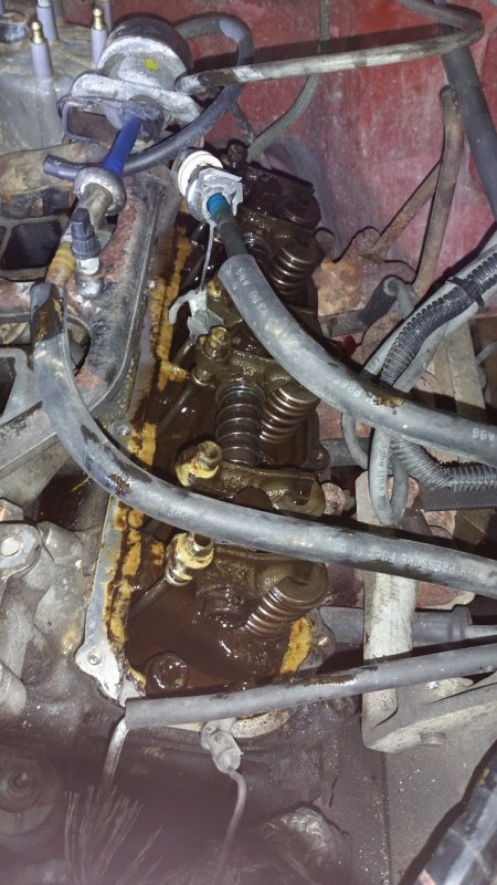

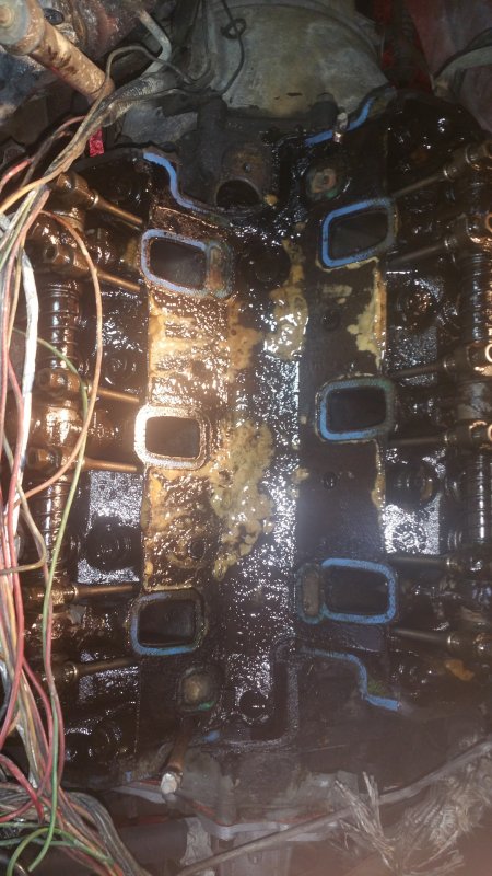

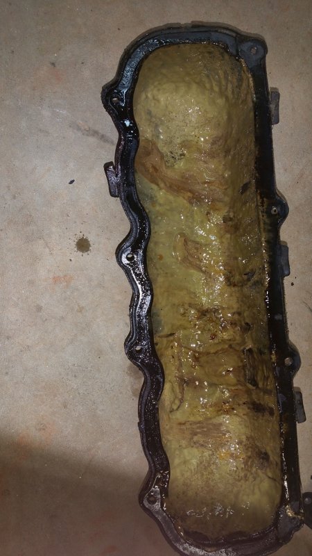

I got the mainifold and valve covers off. It was full of gunk. The manifold had liquid residue all over from where it was sucking it through the valve cover. I guess thats why it felt like it was running on 4 cylinders at times, but still had good compression, and passed the glove test. Tomorrow I'll take the lower manifold off, hopefully i'll find a busted gasket.

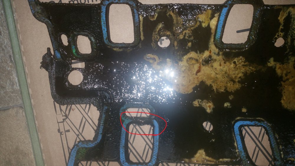

Thanks adsm. I got the lower intake off. On top of the gasket was more oil/coolant gunk. Underneath was pretty clean. Towards the back of the engine had a small chunk missing out of the gasket, that might cause an oil leak. Above piston number 4, the gasket had a hole between the intake and coolant pathway. Not sure if it was leaking there. Doesn't look like it could go anywhere but down through the intake on piston 4. I didn't see anything else real obvious. If I understand right, if it was leaking where I have it circled, it would still have good compression and only pull coolant in during the same stroke it pulls air/fuel through intake?
I already have an intake gasket set on hand, so either I put it all back together and see what happens, or I pull the heads off and check them.
