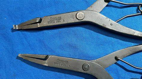

There are special snap ring pliers for that. I generally use a straight pick and a small flat screw driver. The pick can be wedged in under it by going between a pair of splines, then used to lift it enough to get the screw driver under. Then lift the other end with the pick and work it off. Be careful as it is important and usually goes flying.
Excellent, thanks guys. Since I last checked in, my neighbor had a pair of these, only
problem is they don't open wide enough. adsm08, I briefly tried that method yesterday,
guessin' I might have to resort to that way again, thanks. Gump, I appreciate the time You
took to post the pic. Can't imagine Ford Motor Company, God bless 'em, really thought
they were savin' that much money by using a clip, sans ears, for their production !....b.t.w.,
