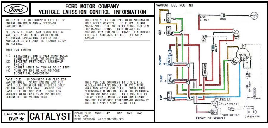

There's probably not much of an audience for this, but if you're as particular as me when it comes to the details, perhaps you can appreciate.
I spent too much time looking for an '83 emissions sticker without turning up anything, got fed up with looking, and so I made my own...I've attached it in .jpg format and if you want it, take it (jpgs might download a bit grainy, and so .ppt format also available). You'll have to size it yourself to fit, and of course print it. I haven't yet, but once I'm done with the restoration, I plan on using vinyl paper on an inkjet and protecting it with clear film.
I've also included a doorjam sticker, and I'm planning on working up a few more (depending on which ones get destroyed).
They're not perfect reproductions, but I suppose they'll do for hand grenades or horseshoes.
