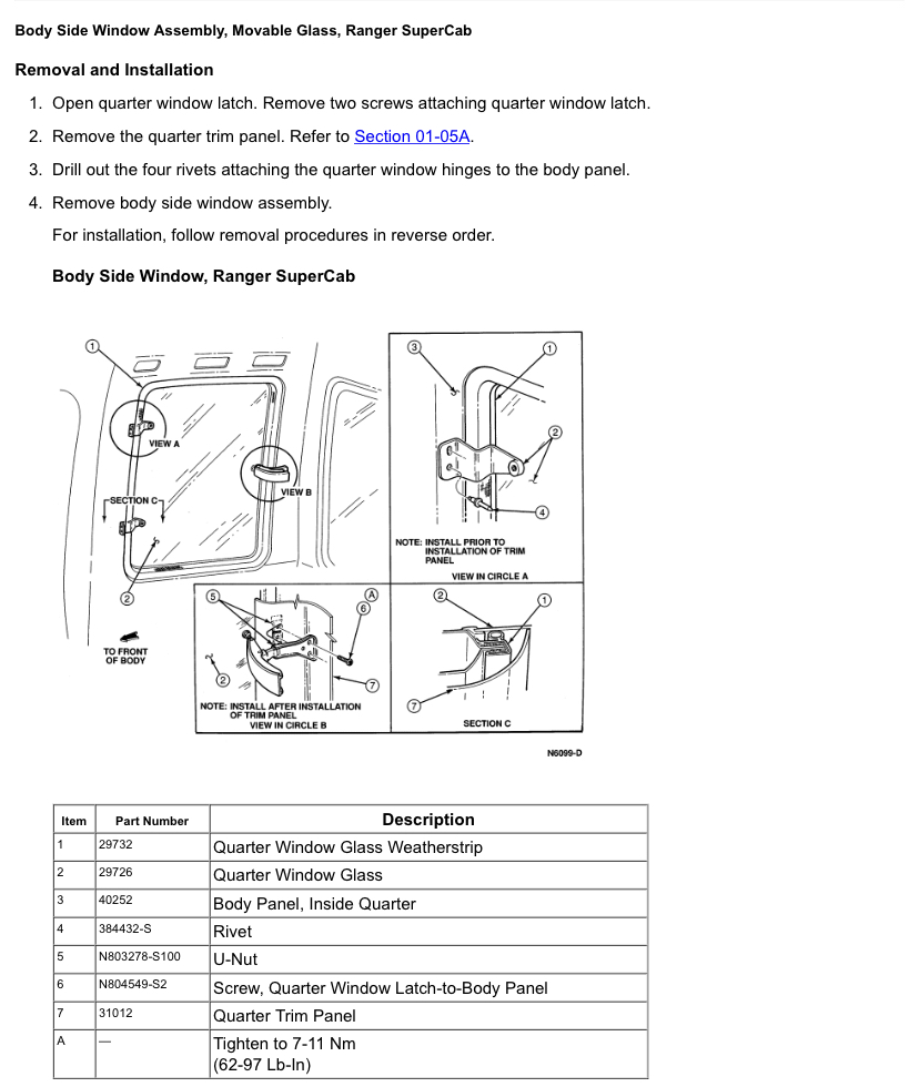

I can show you how Ford installed them…
I believe the sticking point isn't the hardware or the glass but getting the interior trim with the indent for the latch lever that opens and closes the window. From what I understand, the steel frame for the window itself is the same between the fixed glass and the one that can open.
I got as far as getting a set of windows from the junkyard for my '97. My '97 has the indent for the latch in the trim but obviously doesn't have the cutout in the plastic, I took a picture of the donor truck, it's just a triangle hole that wouldn't be hard to make with 3 1/2" or 3/8" holes and some trimming between them... The part I'd be stuck on would be drilling out the holes for the rivets on the hinge end but that shouldn't be too hard...
