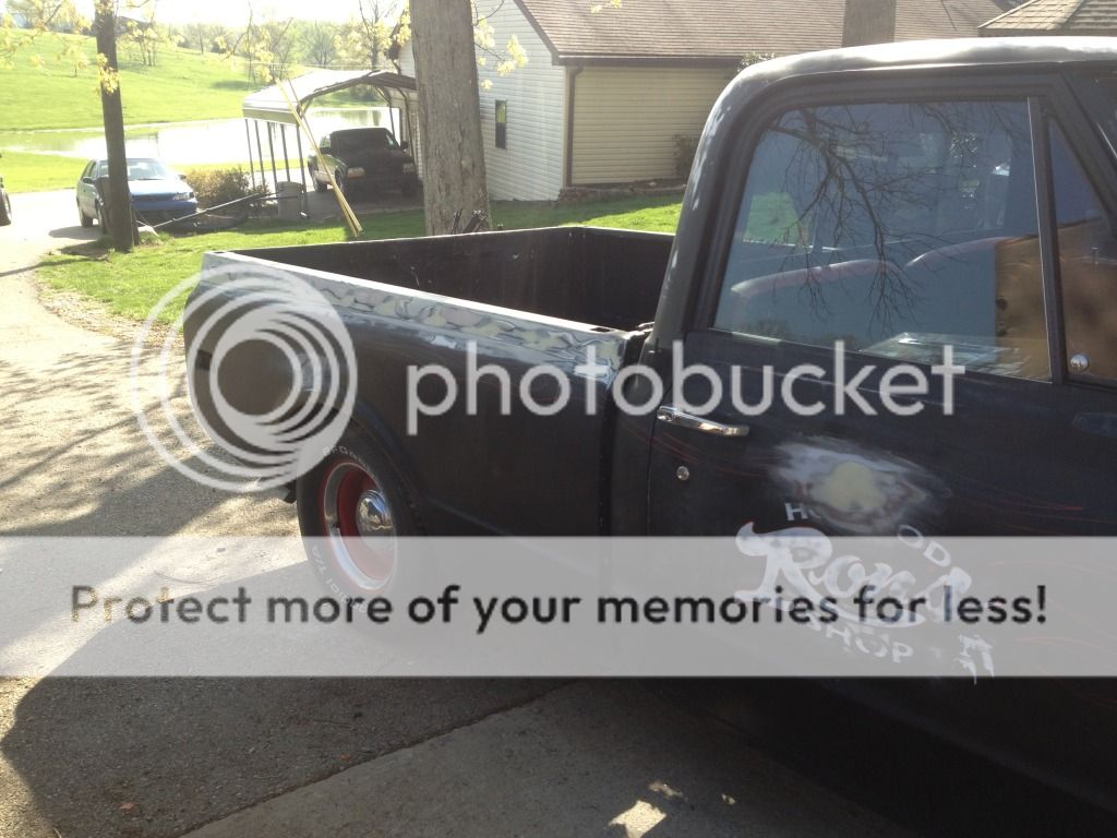

One Mean C10....
I only modified one hub to make sure everything worked out, and it did.
I ordered new pads from LMC, had my rotors turned, then ground down the driver hub, and added a 5/16" spacer and 3/8" longer studs to allow access for the boss wheels. When dad gets his truck driving, we will just swap these hubs with his stock ones. The rears are not yet mounted because we are waiting for the 1 1/4" spacers to arrive. Since my pops wants a tire that is basically the same dimensions of a 31x10.50 on the back of a slammed truck, the tires don't quite agree with his decisions.

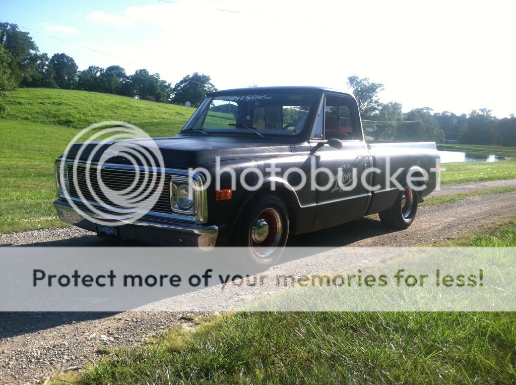

Finally got the brakes done and all the wheels on...
One Mean C10....
Think I'm going to go back to my old wheels...
New wheels would look better in chrome or red I think.
The biggest deal is they rub in the front, and the computer needs to be programmed to the new rear tire size. If the wheels were mine, I'd clearance the inner fender, and reprogram the PCM, but since they are dads, they are coming off tonight.

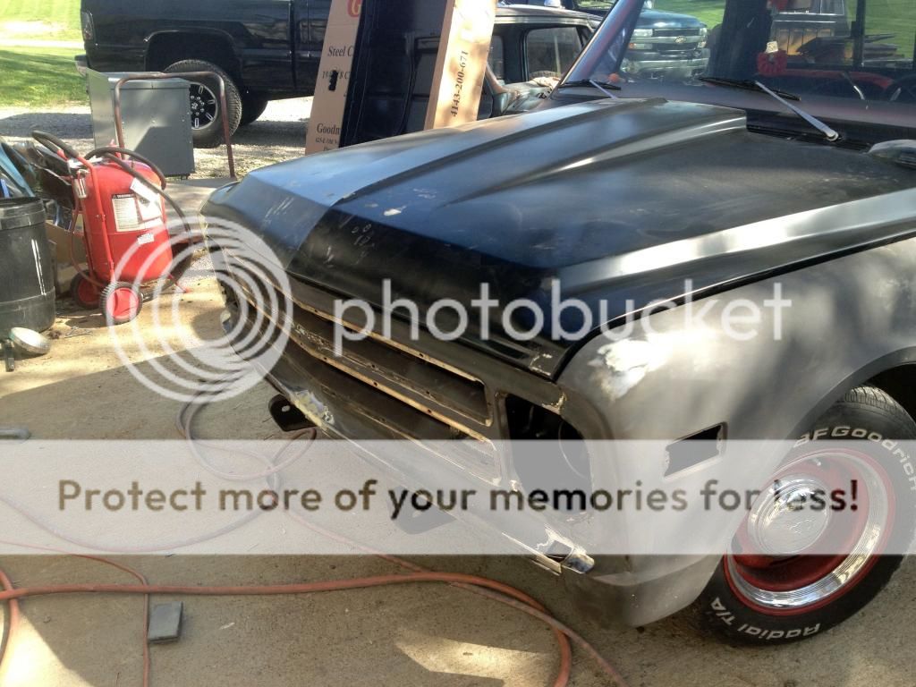

Instead of buying me another $400+ chrome grill, Dad bought me a new radiator support and gave me a fender...
One Mean C10....
The grille and driver fender along with the hood that isn't installed yet I had off my cab from the Leftovers truck. This is as far as we got Saturday.
One Mean C10....
Plans are to get it wrapped up this week with a cowl hood, Euro style headlights, solid back window, and a new coat of Satin Black paint over the whole thing. No more flames or shop truck logo.

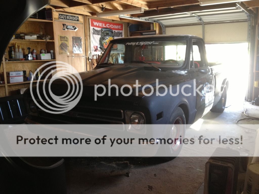

Worked on the ol gal a little yesterday afternoon.
One Mean C10....
Got everything mounted up but the hood. We still have to paint the inside of the hood before installing it, and I was by myself, so I just got all the little stuff done.

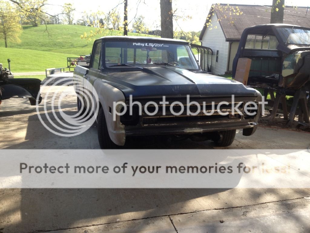

Spent more time on the ol gal this weekend.
The initial plan was to just swap the clip, DA the whole thing, and shoot a coat of GM black and a matte clear. Well, then my pops decides he wants to fix the dents and dings in the bed... and the tailgate... and the doors... and the whole truck.
So this weekend while i was taking my exam, he installed the hood. The new-to-me hinges are bent, so it doesn't sit all the way right. This sucks, but I'll run it like this until i can afford new ones.
One Mean C10....
After the test, I went to his house and we got to work. At the end of the day, this is where we were at.

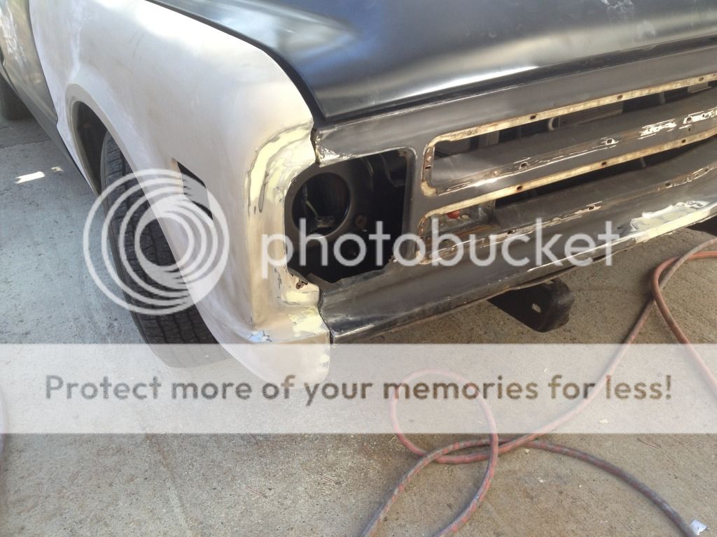

The driver fender and grille are factory GM parts. They were in great shape considering where they came from, and that they were not repos. There was one dent in the driver fender, and the mounting holes on the grille needed to be massaged to line up correctly. The spot in the middle lower portion of the grille was 3 dents. We used a stud gun to pull out the dents, then a body hammer to work on the high spots. This metal was not fun to work with due to it being so thin
One Mean C10....

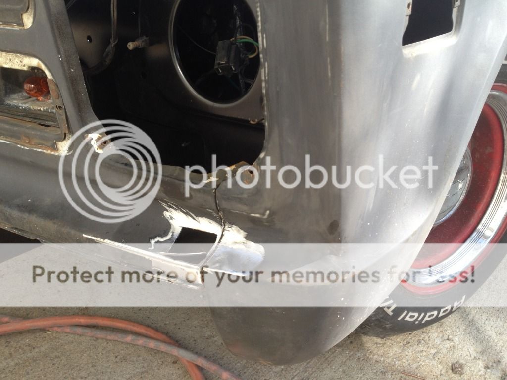

I cut out the small rust spot and cleaned the inside of the hole. This picture shows where we set the fender and grille placement. It took a little work to get them to line up this well, but I think the end result is worth it.
One Mean C10....
So the passenger fender was a painted repo we picked up from a swap meet for 40 bucks. It was in great shape, other than the fact it was a repo. The problem was during the manufacturing process, a group of ripples was cast into the metal around the headlight bucket. Instead of leaving the ripples in there like the PO did, I broke out the flap wheel and sander and worked the area until i got all the ripples out. Then dad put a skim coat of filler to fill the grinding marks
One Mean C10....

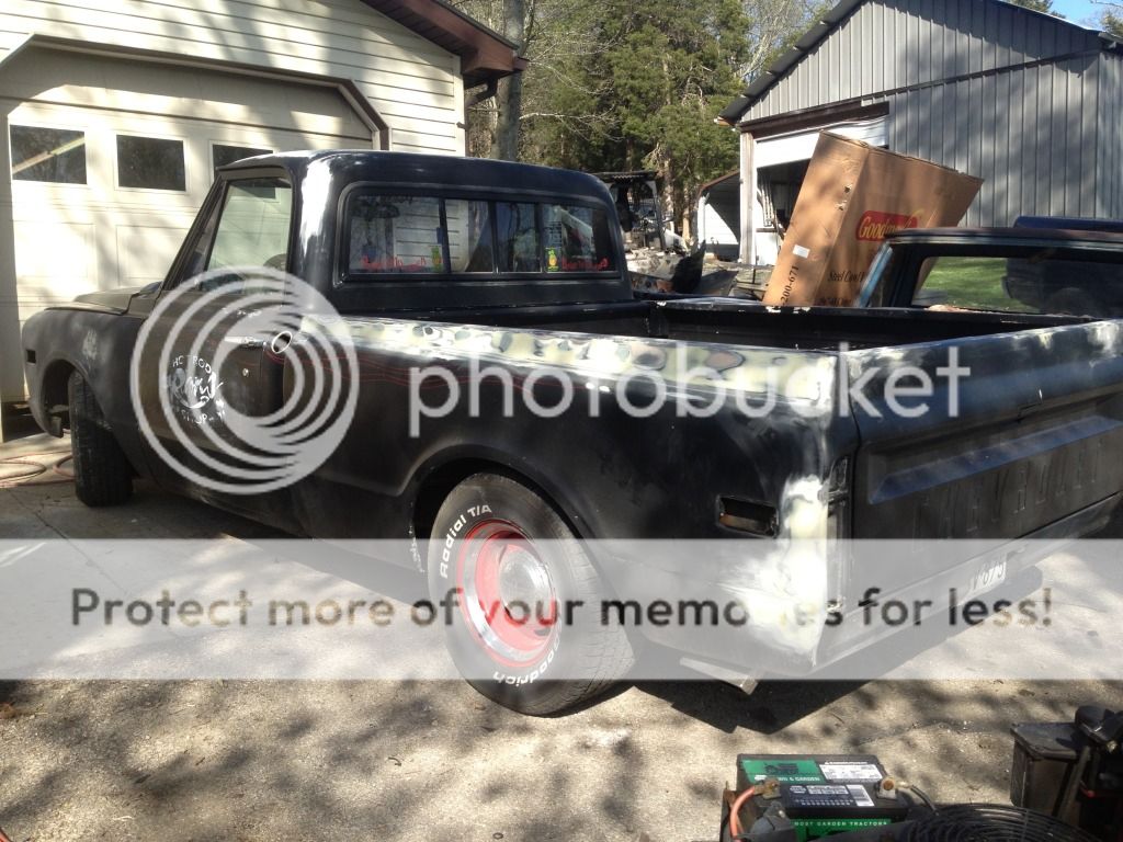

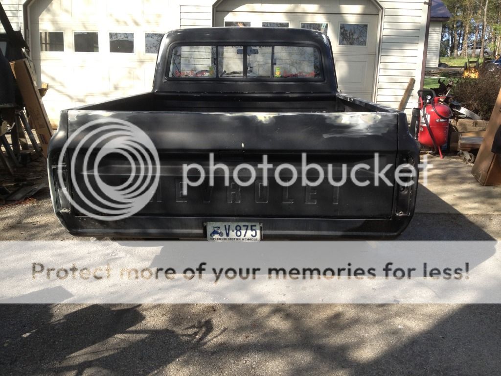

The truck used to have a snap vinyl bed cover at some point. The button holes were still in the truck down both sides of the bed. We spot welded all the holes, then went to work leveling out the panels. Still a little wavy, but after a couple coats of high build primer, it will be nice.
One Mean C10....
One Mean C10....
The bottom section was a giant dent that happened a couple years ago when one of my dad's employees backed a trailer into the truck. We used the stud gun to pull it out, then a skim coat of filler again to help level everything back out.
