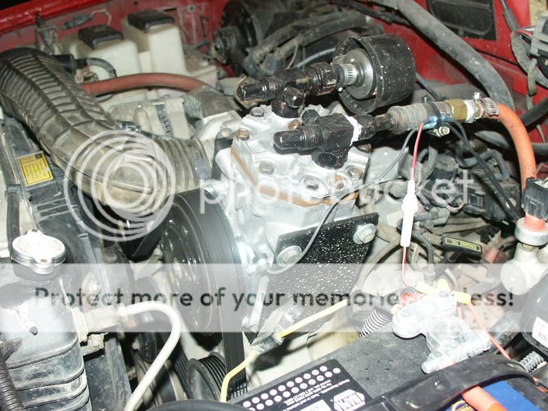

i used a york 210 compressor as well. best mod i think i have ever done. i love to wheel with "jeep guys" and they think they are the only people to ever add on board air. definetly worth your time and money. here are some pics of my install
Do you have a body lift or will it clear the hood without one with it stood up like that?
I love the york on my wifes cj7. Need to get one on my ranger.
the older style 6 cyl r12's work great. the newer style 10 cyl wont take it...different slide shoes etc...
of course the yorks are good, but the 6cyl style i used put out more then the one i had off the old dodge.
