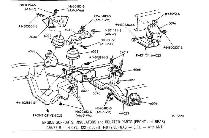

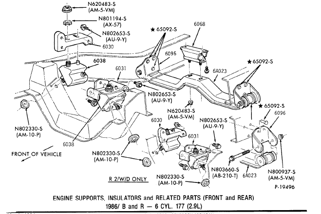

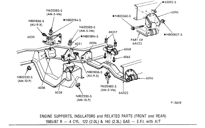

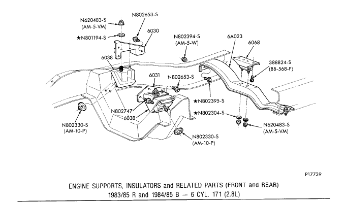

AT and MT use different mounts if that helps at all. If you don't know how to work Ford part numbers let me know, otherwise it will be mildly confusing why they all have the same number in the following pictures...
But watch out for the V6 mounts, they look similar but may be different...
