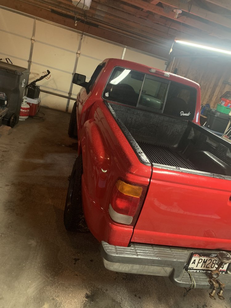

Alright guys I could use some help here. So my girlfriend and I enjoy putting blankets down in the bed of my 98 and falling asleep under the stars. She’s asked on numerous occasions when I’m going to put speakers back there. Well originally I was going to just buy some Bluetooth speakers but then I remembered my head unit has a sleep function where it will turn itself off after a certain amount of time. So let me ask you guys… how would I go about doing this? I have the wiring situation mostly figured out (reroute the rear speakers), I just have no idea where to get speakers for my bed, what kind to get, or where even to put them. Any suggestions would be appreciated!
Also here’s a picture of the truck I’m working with:

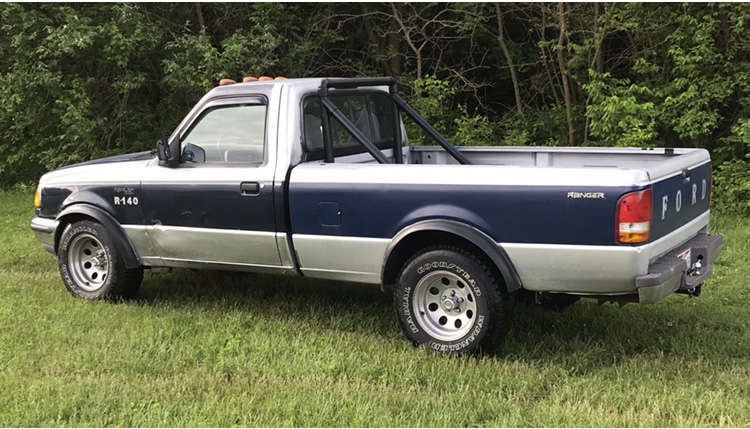

I actually cut down a GoRhino cab faring from an F150 to fit my Ranger, and it didnt look half bad. My off road lights were on top, and I had a setup where I could mount 2 outdoor speakers on the underside of the bar behind the back window. It could be driven off of a small 2 channel amp with bluetooth capability. You could have the small amp mounted inside the truck, run the wires to the speakers, and have your phone simply link to the amp. Piece of cake.

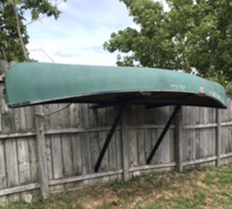

You could always take pvc pipe and build a faux roll bar, been there done that. It looked cool but the only person that couldnt tell it was really painted pvc pipe was my mom (who once tried to remove the vaccum motor from the air cleaner snorkel on a 302 comet to add oil) My faux roll bar is now mounted to the inside of a privacy fence as a rack for the canoe. I think I spent about $30 total making it including mounting hardware and paint.
