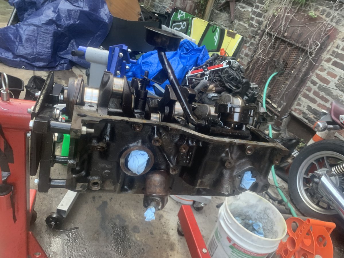

So I’ve been refreshing and cleaning this 88 TC engine in a friends driveway–disassembled everything, cleaned the block and head, cleaned+rerung pistons, cleaned valves, ported to the best of my pretty limited ability, replaced a couple of sensors, de-rusted whatever had rust on it (a lot of stuff it turns out), cleaned and rebuilt the turbo, repainted a few things and now I’m in the process of finishing the head and preparing as much as I can before I put everything together and hoist in to my truck which I’m still driving all over the place and still has the 2.0 automatic trans in it. I also decided I was going to do a 3’’ body lift while I’m at it and convert to the T5 manual transmission that came with the engine.
Using a 8ua computer and a stock harness i found on eBay which I yet have to label, but I think it’s complete.
This is a month ago-ish

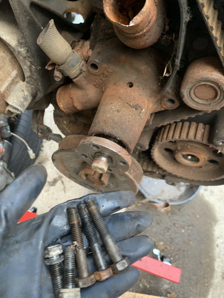

And this is the slow and painful process of beginning to clean it

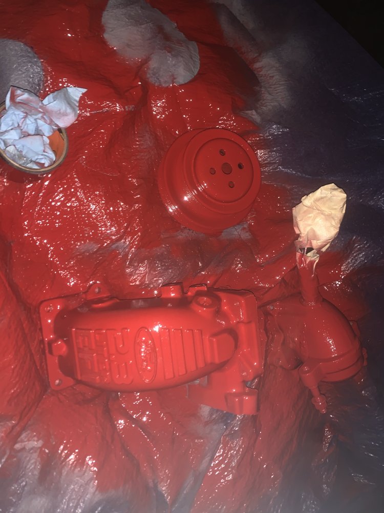

Started to paint stuff eventually
45494

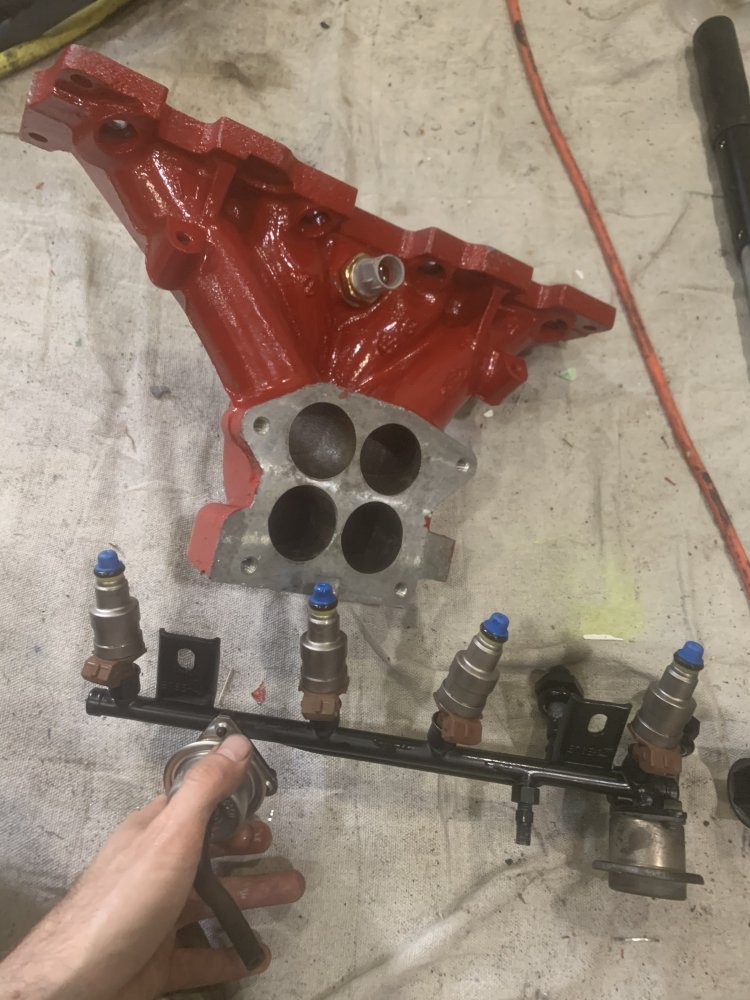

Couple new sensors, rebuilt the fuel injectors...
45495

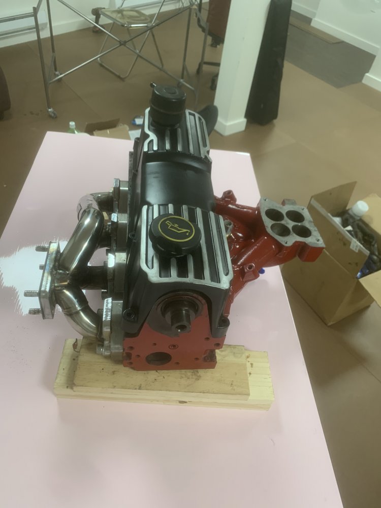

The cleaned up head with the flipped header on a table Waiting for a bunch of stuff to go in..

Where did you get the header?
eBay I think! had to grind out the part that connects the pipes together at the head because when it was flipped it completely blocked the spark plugs. It’s a weird design also, comes with socket head bolts that throw the whole alignment of the holes to the head off— the bolt hit the pipes and I had to eat quite a bit of metal for stuff to align..

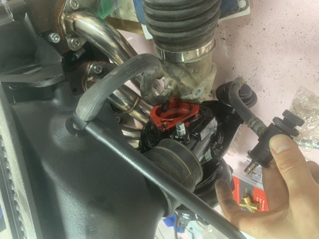

Any boostheads able to weight in on this or suggest some reading material? Trying to figure out the Gillis valve connections and confused here (I don’t have good photos of how the vacuum setup was before I dismantled everything either). Turbo outlet is plugged, one of the air outlets on the turbo intake is capped off, boost valve out goes to wastegate, boost valve inlet will be connected to vacuum tree later. Now what happens with the vacuum fitting on the intercooler and the one on the air intake? Plug both?

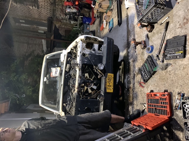

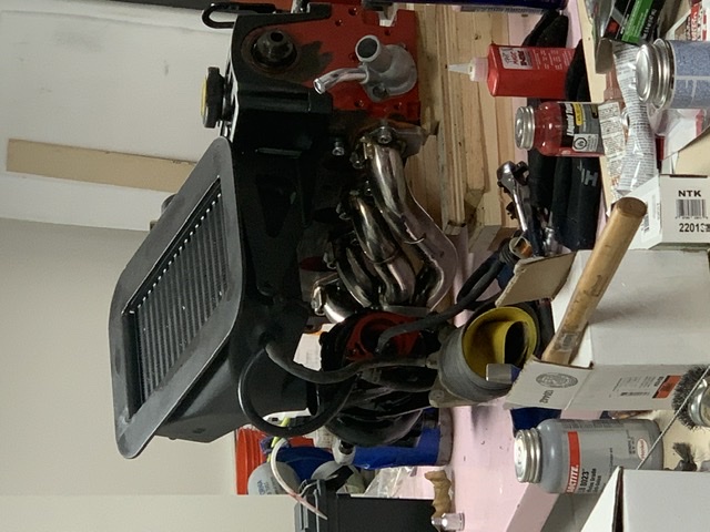

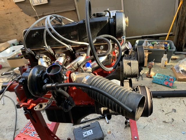

Alright fellas, I’m not very good at consistently posting about the “build”, but after working on the head for a while in my office and reading stuff+ordering parts, my friend and I decided to use the couple of days we have in another friends driveway to do the swap. It’s wild. I‘m sure I’ll have more meaningful questions but right now what I’m really wondering is: how do you remove the body panel that holds the headlights? I need that thing gone to hoist the new engine and trans in (want to do both at once) and it seems welded to the other panels or something!
Just a few details to be taken care of plumbing the coolant hoses on the turbo side on the tc engine, change the T5 transmission seals, put it all together, pressure wash and paint the engine bay with.. Eastwood Underwood black I guess, and it’s ready to go in and get hooked up to driveshaft and harness and the frame. We’re doing 14 hour days, it’s very insane and fun. Changed all the gaskets, bearings, belts, I think I did the timing right, put in a few fasteners, brackets and the ac compressor from a 93 mustang engine I had lying around, cut into a bracket to get the power master alternator to fit, came up with a hybrid pipe/hose system for the coolant which I’ll try to insulate where hoses are too close to hot parts of the engine...
Couldn’t find an AC airbox so I’m installing everything else (mustang 93 compressor clears the turbo fine) and I’ll figure out the air box when or just before it gets warm Again over here. Switching to manual is gonna be interesting, I have a new slave and master cylinder, pedals for the clutch and brake and a new clutch cable but I don’t understand how we’re gonna install that ye—-cross that bridge when we get there.
bunch o photos:
47781
47782
47783
47784
47785
47786

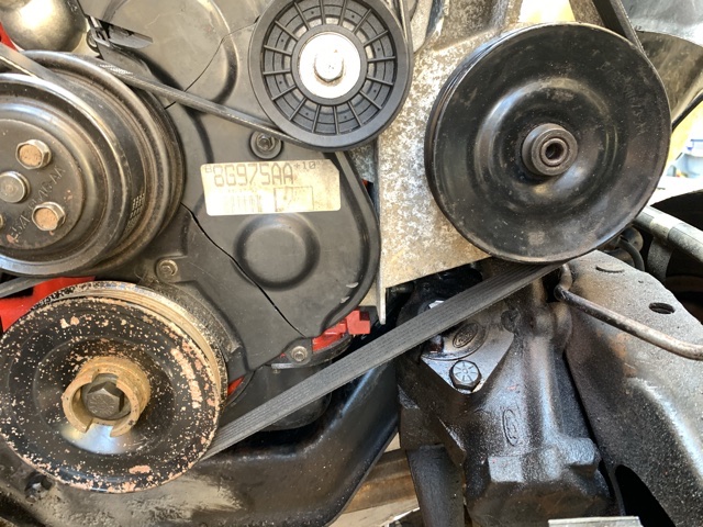

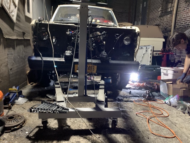

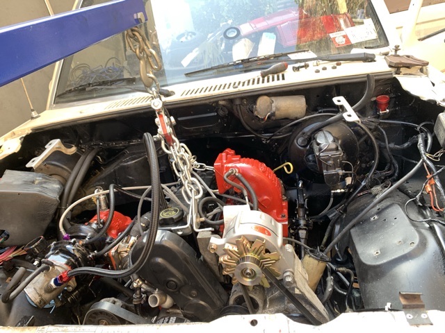

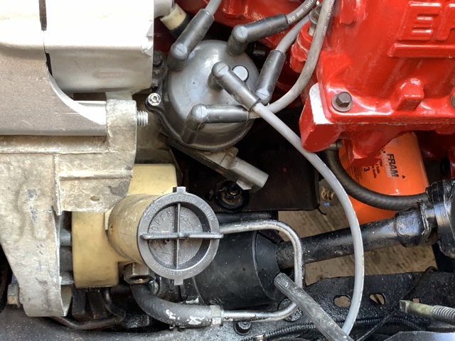

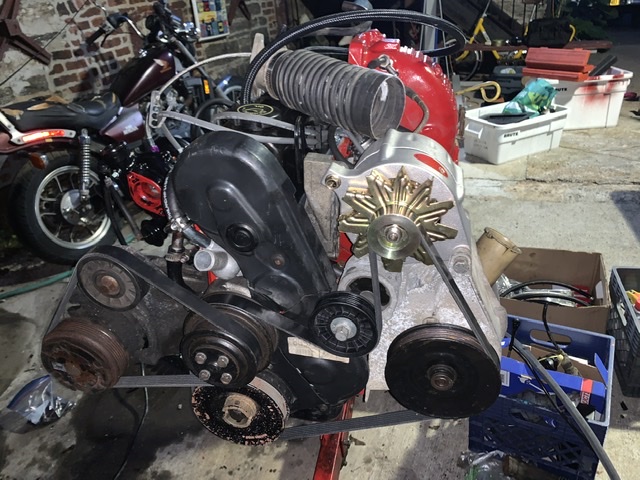

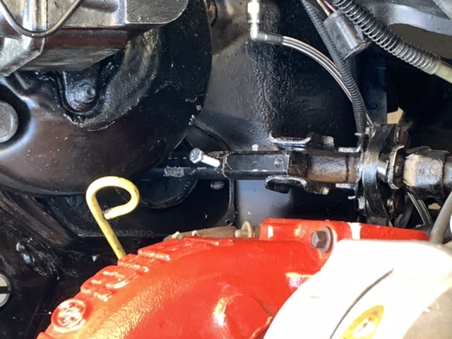

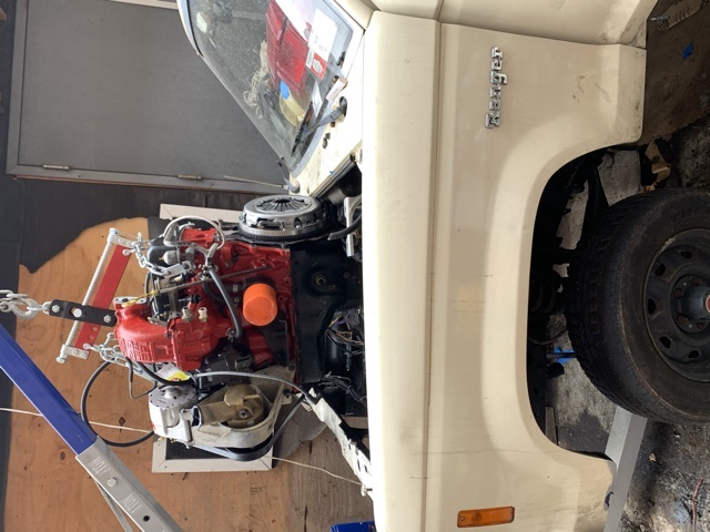

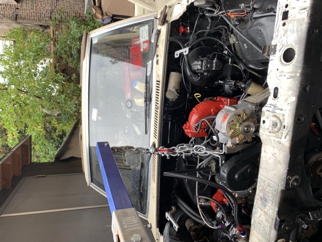

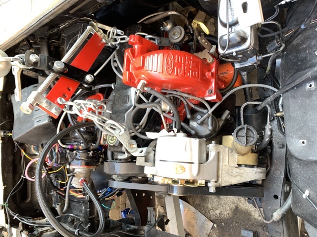

The engine is being dropped in finally! Finally figured out that the clutch is a hydraulic system and a few other things I had guessed wrong. the main hurdle right now is that the power steering belt doesn’t seem to clear the bolt on top of the gearbox (which I’ve shortened) and the engine feels like it’s sitting too high on the frame although it’s on my 2.0 mounts using the same mounting brackets transferred from my identical 2.0 block..
I put in a 3 inch body lift while the engine and tranny were out and now the steering column doesn’t connect even with the extension. I thought putting the engine back in would add weight to the frame and fix that but it doesn’t seem to do the trick.
I haven’t fully released the engine from the hoist because it falls backwards (haven’t put the transmission in yet, about halfway done on that. It looks like the crossmember is the right size?!)
do those sound like issues that‘ll sort themselves out once the tranny is in?
here are some pics of how it’s sitting. You can see the oil pan is kind of high above the frame, 2-3 inches. Also the wheels are almost in a v shape, as if the framed was jacked from underneath, but it’s not! The truck is sitting on a slight incline with the back wheels on ramps..
Looking good! I can't speak to the height of the engine, but I imagine if you used the same motor mounts as the 2.0 it should be fine? Also, if the engine were any lower your belt interference problem would be even worse I think. It does look like the 2.0 and 2.3 engines used the same motor mount from 83-88, and then in '89 they changed. Someone with more 4 cylinder experience may have more insight on this one.
Most body lift kits come with a steering shaft extension, as they are usually needed. Your suspension should level out once you install the engine and trans all the way, along with rolling the truck forwards and backwards. The positive camber is a result of twin I beam suspension design.
I'll have to look around a bit to see if someone has ran into the same belt/steering gear problem. Two things come to mind; the engine could be too far back, or too low. Your truck came with manual steering didn't it? I wonder if perhaps all the 2.0 trucks with manual steering came with motor mounts that placed the engine slightly further back?
Okay I just went back and looked at the pics of my old 2.3 with power steering and it looks like the pump on mine was mounted higher and further to the drivers side. Are you using the turbo coupe's power steering/alternator bracket?
Oh interesting yeah it did come with manual steering. Maybe the mounts are the same but the mount holes are somewhere else hmmm
whatever happens later, I figured I would do my best to connect the transmission now, adjust the x member to sit properly and release the hoist to see if it fixes the suspension. I put the steering extension in but it needs to come down another inch to connect to the lower steering shaft, it’s almost there..
I’m using the turbo coupes alternator bracket yes (butchered in a few places to accommodate the p/s hoses underneath). I wanted to use it because it has a tensioner and my old 2.3/2.0 bracket doesn’t (you have to Jack the alternator with a crowbar to set the tension or something). I still have the old bracket, maybe I’ll have to put that back in and make it work. Hey maybe I can even try to force the tensioner to fit on there somewhere!
After looking at a bunch of pics, I bet the Ranger bracket will solve your issue. With a little modification/fabrication I bet you can get a tensioner in there somewhere. (y)
