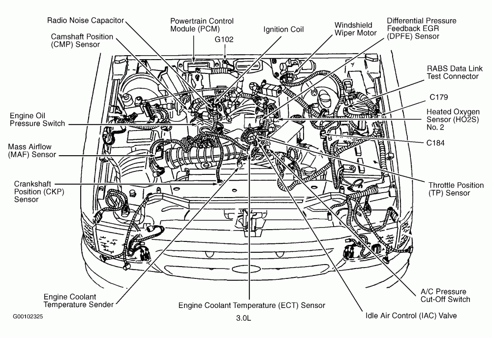

I am doing to oil pressure gauge fix and would like to know where is the oil pressure switch located?
Right side of the engine block towards the rear below the head. Only thing threaded into the block there with a one wire connection.
Yes, behind the passenger side head on the block next to the bell housing
Not sure the PS60 sender will fit in there, may need to add an extension
