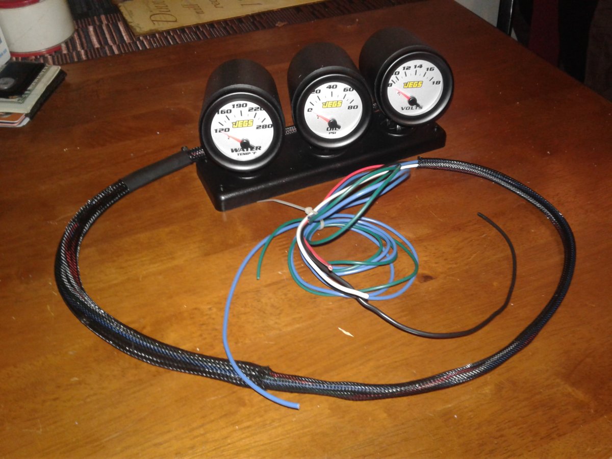

Maybe not the best solution... but a real set of gauges are way better then what Ford designed In.
