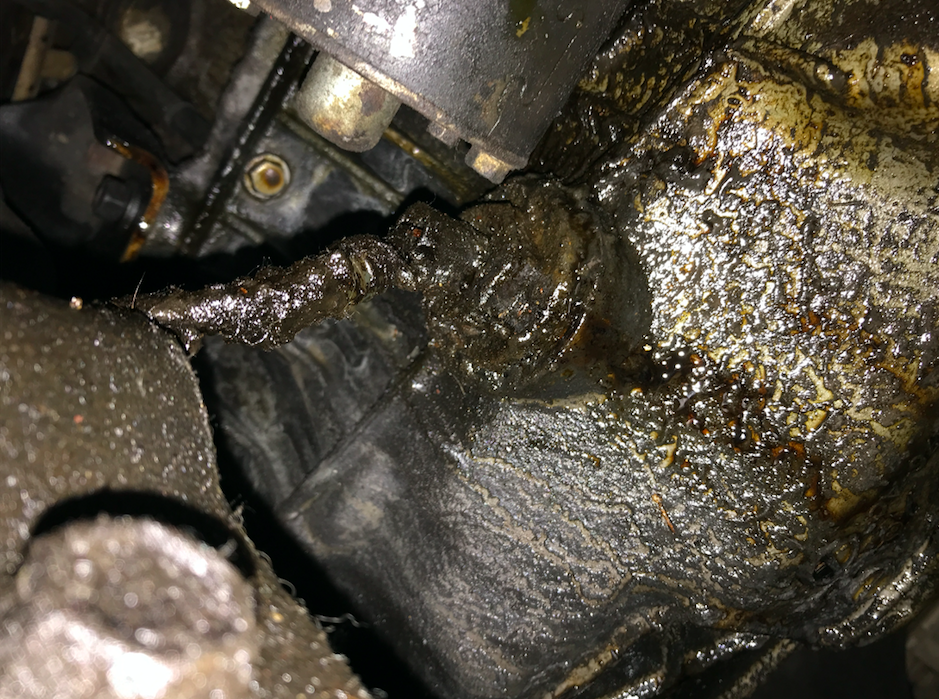

I installed a new sender and it still showed no pressure after I started it up and let it idle a few minutes. This truck leaks power steering fluid, I noticed the connector the sender is wired to (is this the oil level sensor?) has gotten pretty soaked, wonder if that has something to do with it. Should be able to check continuity with a meter. Anything else I could look at?
What happens on the gauge if you connect the wire going to the sensor directly to ground?
Do you mean disconnecting the wire at the sensor, connecting it directly to ground, and leaving the wire boot connected to the sender? How would I connect directly to ground from beneath the truck?

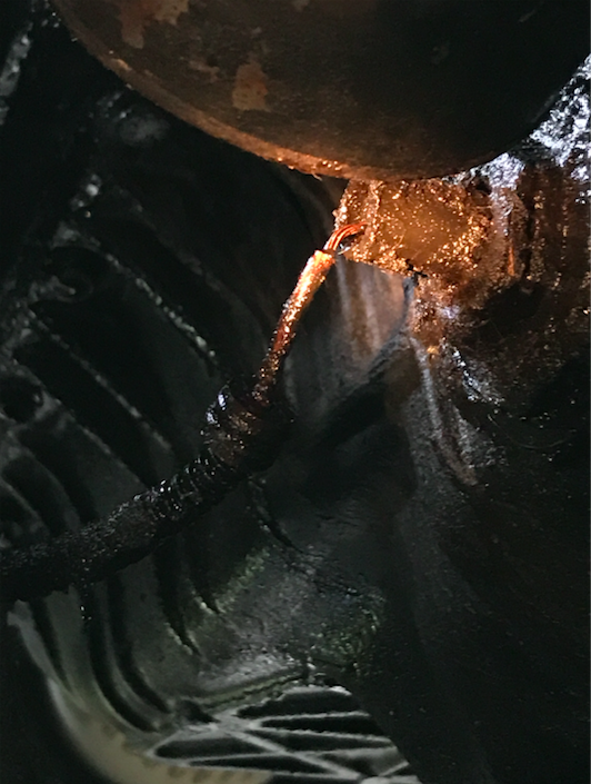

I cleaned some of the grime off the sensor assembly and found the wire going to it is stripped bare. The rubber grommet was hanging loose back on the wire too. Looks like I'll probably need to switch out the sensor and the wire yeah? Maybe I'll try just the wire first.
