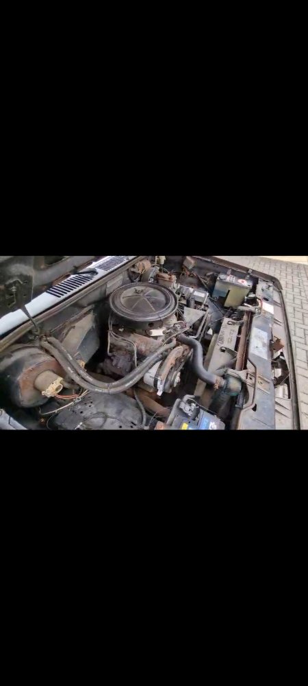

Will have a look at fan clutch this weekend. I have the truck in storage so can't immediately go look at it. Does appear to have top shroud if you look at this screnshot from a video. Will check the bottom of it this weekend as well.

You have what looks like a guard over the engine fan, but your truck doesn't have air conditioning (AC) so I think that is what it's supposed to have. AC equipped trucks would have a full fan shroud, so that the fan pulls more air through the radiator (and associated AC condenser).
