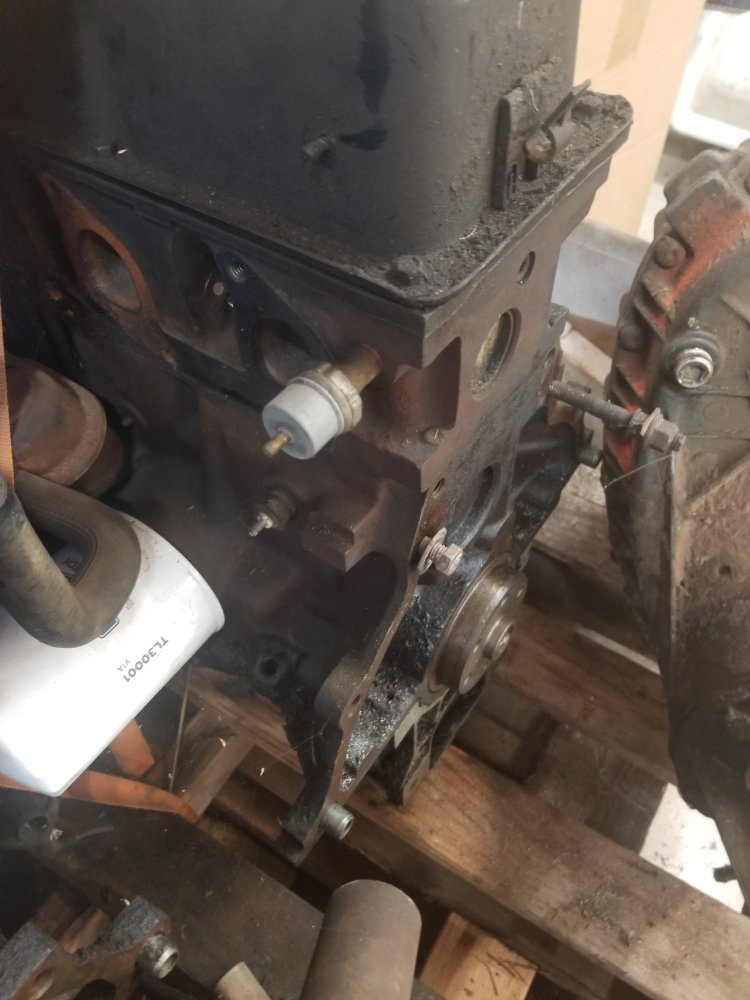

QUESTION :
WHERE is the 2.5L oil pressure switch located ? .
I looked online and they said it's near the oil filter .
No, it isn't .
My presumably original O.P. switch weeps a tiny bit and doesn't turn the gauge on at all until 5 + minutes of driving, I looked but don't -see- the darn thing .
TIA,
Rear of the cylinder head just behind the intake manifold, roughly here:
Taking that long to come up is a bit much, I would question the switch and if that's working the oil pump seals might be going out, the oil pump is behind the auxiliary pulley on the timing belt on the '96ish and newer Lima's...
THANK YOU ! .
