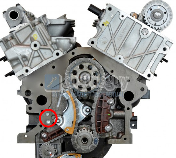

Well, I know it's unlikely, but if anyone has a blown 4.0 with the timing cover off and would be kind enough to drill out the two plugs on the passenger side to see where they lead, that'd be incredible. I can borescope from the inside and see the upper one has a short channel, but then it turns again and i cant see around the bend (I assume the channel leads to the lower passage). I know this is where my plastic piece went but I don't know what it's blocking now.
This truck is a 2x4, and my gut says this passage feeds the balance shaft bearings that I don't have, but I don't know where the oil goes without the balance shaft? Shouldn't it be plugged or never drilled?
