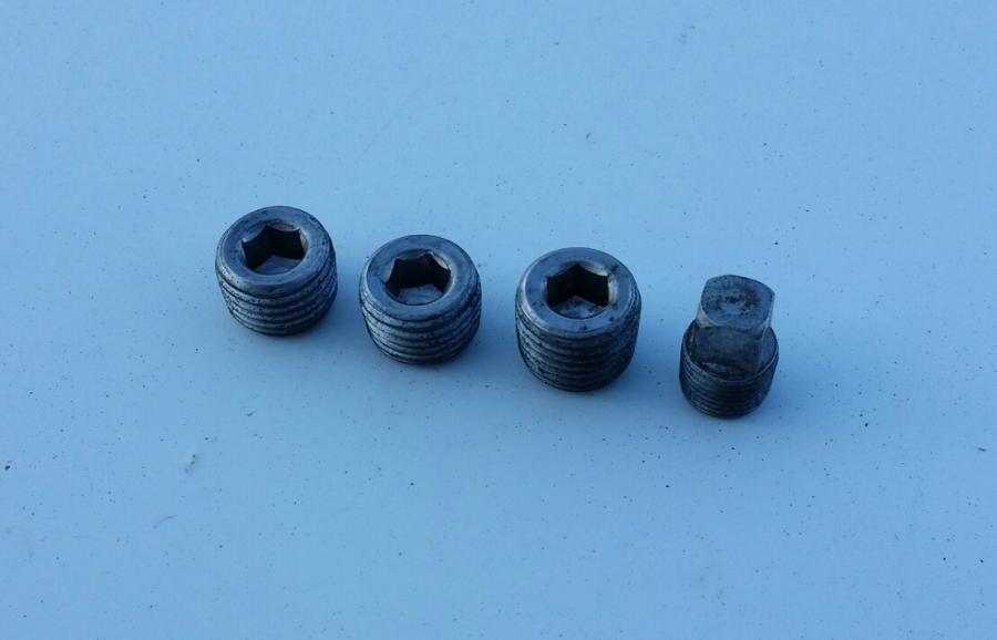

Assembling my 2.9 motor. Freeze plug kit contained a small threaded plug. it's bigger than the coolant drain plugs. I have no clue where it goes. It fits in the location where the oil pressure sender goes, is there more than one oil galley port on a 2.9 block.
Could you maybe snap a picture of it and post it here? I'll look at my shop manual, but I think there is only one oil gallery. The only other place that I can think of is the low oil level sensor on the side of the oil pan :dunno:...but I think that is a bigger plug than the oil pressure sender assuming you already put a plug in there.
These came in the kit.

Hmm....I don't see those plugs referenced in my manuals...I'll look elsewhere :dunno:
What rebuild kit did you use? None of the ones that I can find for the 2.9 in that year range have those plugs.
It;s been quite a while since I've rebuilt a motor, but those look like oil galley plugs. Some areas I've seen them is at the back of a block behind where the clutch usually attaches, and on the back of some heads. If you didn't remove them before hot tanking, then there may not be a hole for your new plugs. The motors I've played with are old style 351C and 429/460 so this may not apply in your case.
Richard
Those look like yhe galley plugs in the top of the head under the rocker arms.
Postin' from teh Galaxy
Bought Kit off E-Bay. Heads are still at machine shop, did zero disassembly on them before I dropped them off. I'll double check them when they come back. Looking like the manufacture tosses a few in to cover every application.
