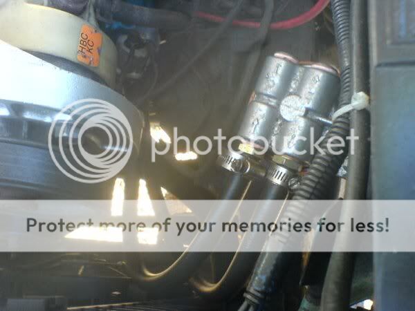

I mounted mine where the charcoal canister was, I thought about the inner frame rail but decided it would make a big mess when I changed the oil. It is very easy to get at and install with the filter pre-filled.
http://www.therangerstation.com/forums/showthread.php?t=61372&page=17
My '97 has the battery on the driver's side. I mounted my filter to the battery tray, directly above the frame rail. (where the charcoal cannister was...)
The original adapter shown with hit the steering box on anything 1997 and older. Unless you've got the engine in a really strange location. (up high, and moved forward)
Truck is complete, by the way, these pics are from the build.
not trying to hi jack, but what radiator hose is that for? what year and what motor? i got one today for a v8 explorer ( 98 i believe) and it looks nothing at all like yours
The upper hose is from a 5.0 Mustang. We did trim a section out of it (on the top as you see it here, under that corrugated stuff). It fit fine without splicing it, but my bro did it for some reason. I was looking at the picture earlier, too...
Looks like it maybe mounted in the opposite direction from when it was on the car.
