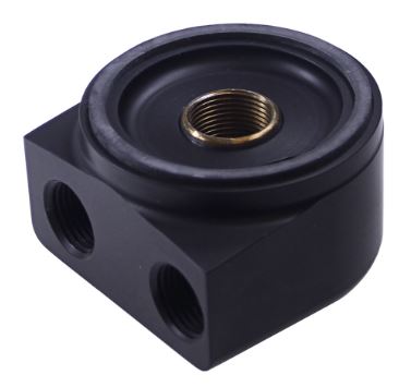

I use the one Bobby posted, but I wish I would've bought the L&L version. It's a much nicer unit, and can be clocked any direction you need it to point. I did convert my Transdapt unit to use braided stainless hoses and AN fittings though.. That eliminated the leaks for me. The way I directed the hoses makes sure the unit stays tight on the block.
The Transdapt unit seems to be the lowest profile model on the market for the Ford engine family. I bought other brands to begin with but they were too thick and wanted to hit the steering gearbox.

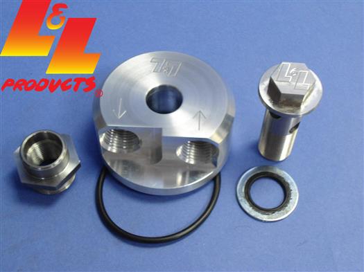

Here's the L&L: https://www.landlproducts.com/details.aspx?c=0&sc=0&ItemID=1020

I went through this on my first build in 2001. Bought the TransDapt, it leaked almost immediately. Took off the header to reseal it. Of course you have to take the braided hoses off to unscrew it. Put it all back together, and now it was leaking at the female threads in the adapter. When I put the hoses back on, I wanted to make sure they wouldn't leak, so I tightened them pretty tight, with teflon and pipe dope. (BTW, I'm a master plumber of 45 years retired.) The POS pot metal adapter cracked at the female threads! Bought the Canton, adapter and had it on for 11 years without any leaks.

The Canton unit is nice, but it's way too thick for many swaps.. It depends on the truck and the engine placement.
I really think the L&L unit is the nicest one on the market. It's worth the extra cash in my opinion, just because it's clock-able.
