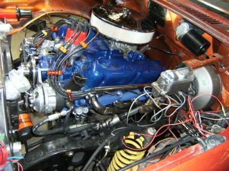

I have mine coming out of the plugged outlet. can take a complete pic if you need it. seems to work ok.
cheers
Thanks for the info. No pic needed. Just wanted confirmation from someone doing this that it was working fine.
