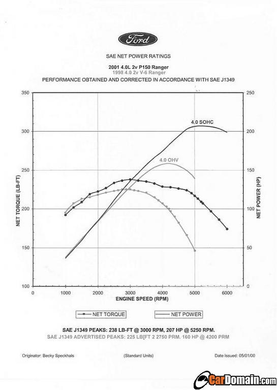

I saw this in another thread, somebody said that Will posted it. It does look line the OHV has slightly more torque between 1000RPM-1500RPMs:
Which is right where your RPM sits when doing many types of wheelin. For example, when rock crawling your RPM ranges between 900-1200RPM.
i think those trucks would have both done better if you had swapped the gears from one to the other.
Personally for a wheeler/towing, I'd choose the 4.0 OHV. For a street truck, I'd choose the SOHC.
I believe you're right about swapping the gears. For the OHC anyway. The 4.10 would make up a little bottom end and the Cammer would rev a little higher. It would be better all around. Just my thoughts.
Thanks for the graph.
