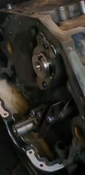

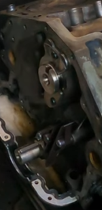

So my son and I have been very slowly working on his Ranger. The weather and life just hasn't made it easy to get to. Anyway, we finally buttoned it up today and it's not running. We did the timing chain components (we were already there, so why not) and the camshaft synchronizer and valve cover gaskets. So, after the truck wouldn't start, I was doing some digging. I think we installed the top timing cam upside down.
The only video I could find on the webs doing a timing chain replacement on a 4.0 OHV had, with cylinder 1 at TDC, the bottom crank key at 12oclock. The top cam had the dot also at 12 o'clock. (see video screenshot). This is what we followed.

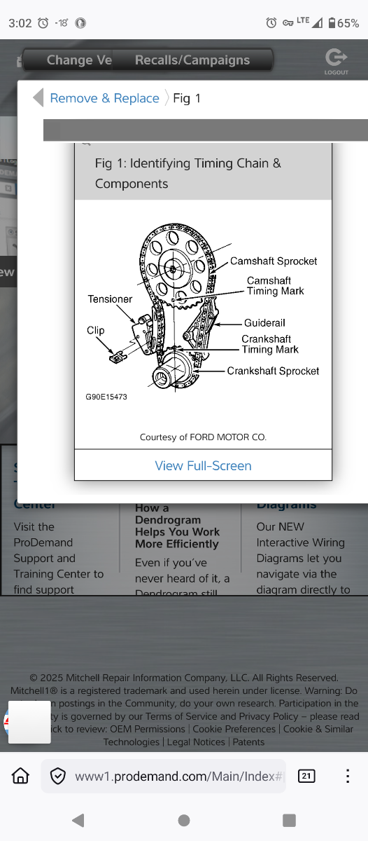

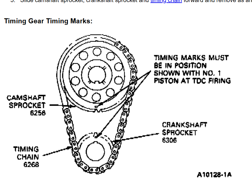

But, and I can't find this but in one place - (on charm dot li) - I found a picture that shows, with cylinder 1 at TDC, the bottom crank key at 12 o'clock and the top cam with the dot at 6 o'clock! Please don't tell me we followed the only video we could find on this and it was wrong. (see screenshot of drawing)
Please help - do the dots point both at 12 or bottom at 12 and top at 6.
I have a feeling you did it upside down. Not the 4.0 but other engines I've done the dots were always close together.
Well, I was hoping i had a picture while my engine was apart but nope.
It's crazy. The video we found was a 4 part series on just this motor. It was very well done. So we followed his steps. It's so hard to find good solid info on this motor.
I think you are right @alwaysFlOoReD . I think he (and therefore we) put them upside down (both dots at 12). The drawing screenshot is supposedly out of a Ford manual. I'm assuming they mostly know what they're doing!

The dot on the cam gear and the dot on the crank gear should be pointing at each other.
Sounds like you're 180 degrees out of time.

The cam would be 180 out.
If you rotate the crank one turn, the dots will line up. You didn't break it, but there may be an issue with the cam synchronizer timing. You may have to pull the shaft, rotate 180 degrees and drop it back in...
So @Jim Oaks and @alwaysFlOoReD . If the dots are at 12 and 12, I do two rotations, I have the dots at 12 and 6. Is it the fact that they are at the exhaust stroke vs the compression stroke (or vice versa). And thank you for the images!!!!
That's what I've been told as well, @Mechrick . And that makes sense as they are at half time rotations (if that makes sense). They'll meet back up. But we put the synchronizer in the right way. We used the key cap. And when we tested this afternoon, I found TDC and low and behold, the key cap dropped right in on the sensor. Lined right up.
