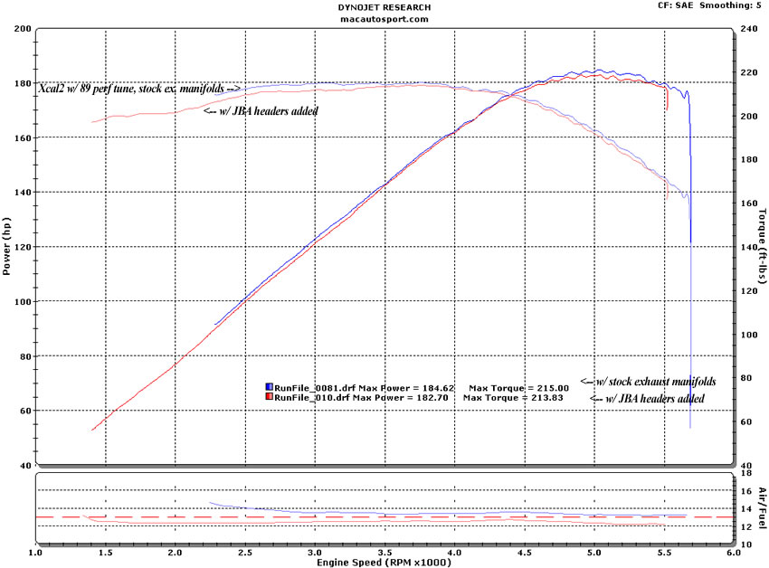

@MSGia - fyi, I put a set of shorty headers on my sohc 2003 Ranger and dyno'd the truck before and after. The torque and power actually went down with the headers! Unless you have another reason to put on headers, I would spend the money on something else.
Guy who runs the Sport Trac board scored a deal on a used but unused set of JBA's still in the box. He dyno'd the Trac before and after and found a difference of less than 5 hp. It's not that the headers are bad, just that the stock manifolds are pretty good.

I was able to find the dyno graph for the 2 runs:
What was interesting is that you could feel that torque bump just before 3500 rpm with the JBA, so the "butt dyno" said they produced more power, but in fact they were just catching up to the stock manifolds at that point.
Well, thanks for the dyno graph. Better save that 370$ for some air suspension…
the dyno graph is good. congratulations with finding out the factory tune was spot on...

@bobbywalter - it was a Bama Tune that I ordered telling him that I was going to put the headers on, so he had accounted for the headers in the tune. I had the same tune in both of those runs. Later I got the SCT Pro Racer s/w and did my own tuning, but that was after I added the supercharger.
