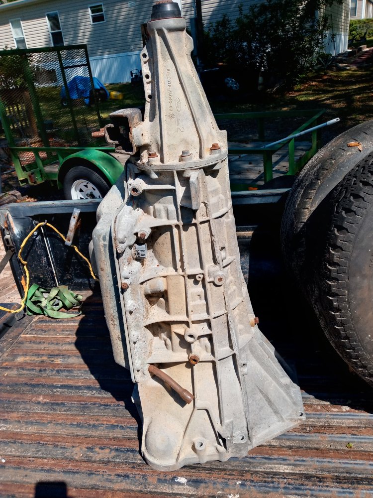

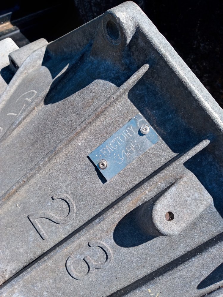

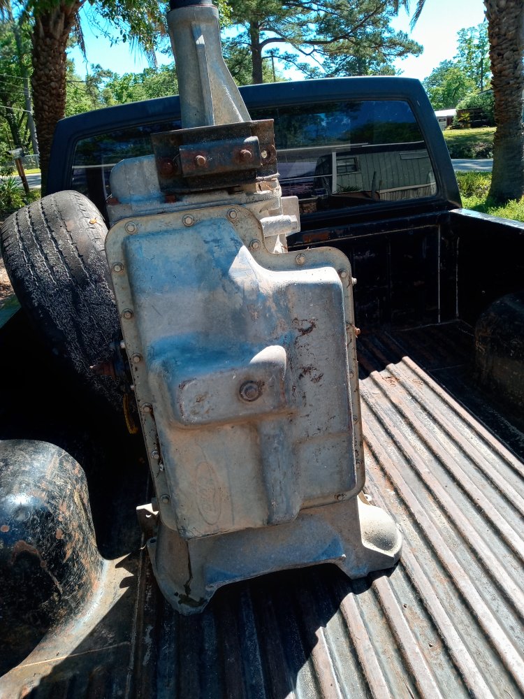

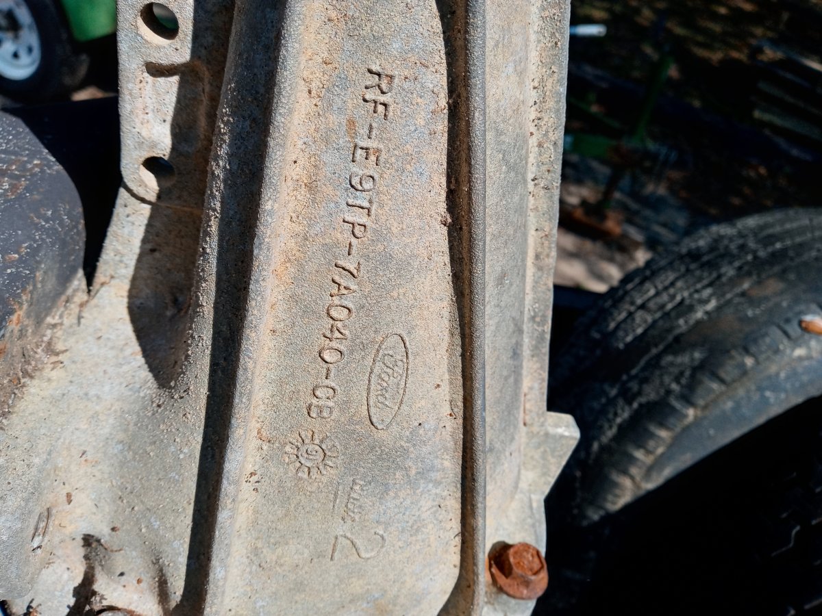

What transmission is this?
74976
74977
74978
74979
74980
+1 ^^^
The E9TP-xxxx is the tail shaft part number, used on E4OD or 4R100
The F0TP-xxxx is the transmission part number, E4OD
@Sloaner4 you can have this one if you it will work. Come and get it (Tallahassee)
C6 w/OD
AKA-E4OD
