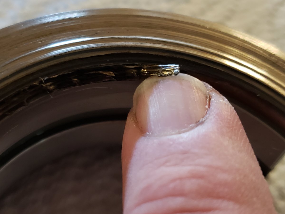

I got a 4R44E issue for you...
Ballooned torque converter.
Looks like I'm going to be opening it up sooner than I wanted.

Not common on this unit at all. Really not on any non modified unit. If the truck was used to tow or carry a heavy load continuously in a partial stall condition this might happen. Trashing the pump would be more probable.
