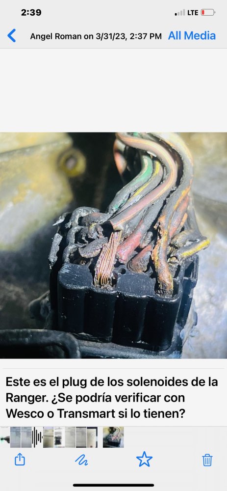

Well, i have problem with the external wiring harness of my Ford Ranger Splash 1995 the one that goes to transmission: broken ,burned and can't find a replacement ,any suggestion i try the web and nothing?
Wrecking yard?
Wrecking yard?,i visit few yesterday and found nothing.
Do they have an online cars lists, or maybe even a NEW addition list?
I wouldn't tell them what I'm looking for, just maybe trying to keep up with anything I might need or want to use, nor would I go straight to it when I did look one over
...problem with the external wiring harness of my Ford Ranger Splash 1995 ...transmission broken ,burned and can't find a replacement

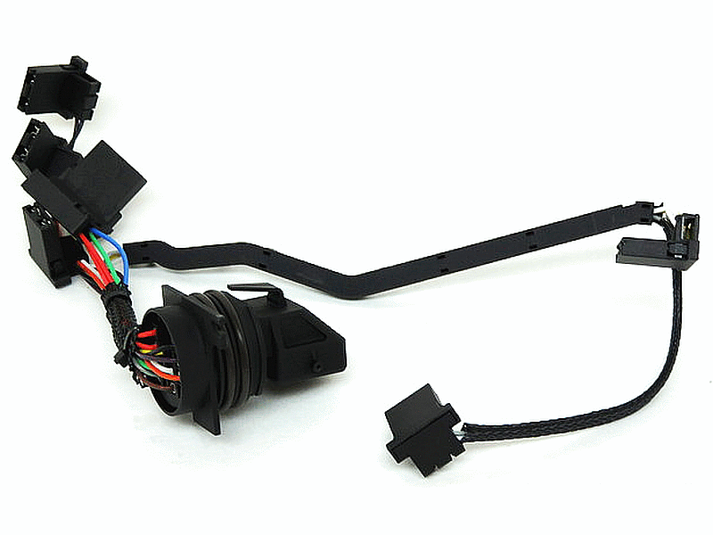

I know they do sell new 4r44e\5r55e Transmission internal harness 16pin Plug, opposite connecting side of what you need.
I never seen\found anyone selling the mating external harness 16pin Socket.
Below is a Pic & PDF on the internal harness.
Is that external 16pin Socket melted beyond repair; perhaps you can re-pin & ButtSplice in new wires?
