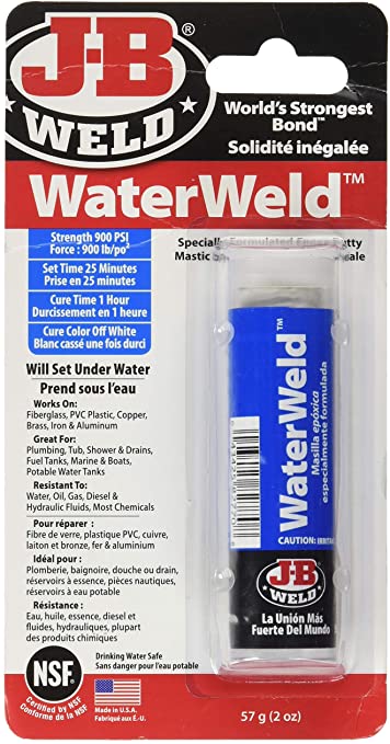

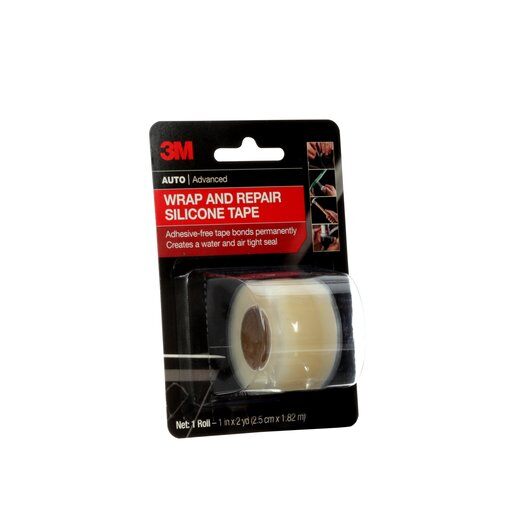

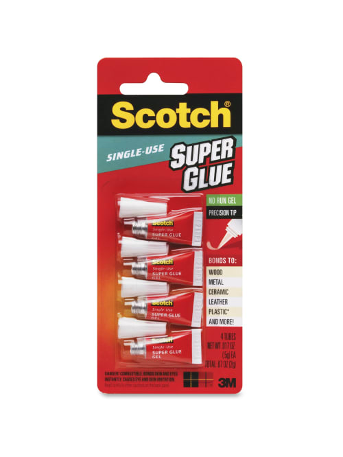

Besides the obvious electrical tape and 100mph tape carry some 3M self fusing silicone wrap, a stick of JB water weld putty, and some single use super glue tubes.
Silicone wrap can fix broken hoses, lines, or even a radiator or thermostat housing. It can hold quite a bit of pressure, doesn't need the surface of what you're fixing to be clean or smooth since it stretches and sticks to itself, and it's pretty impervious to a fair amount of heat.
JB water weld can plug almost anything including gas tanks (while still full of gas). I used it once to fix a hole in a transmission pan while transmission fluid was still pouring out. I kept driving the truck for a week with the water weld on there before actually replacing the pan. It probably would have lasted years.
A few tubes of single use super glue are a good idea too. I think you can buy like a 6 pack of the one time use tubes which are alot better for an emergency kit than a single full sized tube since, well you know super glue dries out once you open the tube. Plus they are about the size of a dime so you can stick them anywhere. I keep them all over the place.
If you can't McGuyver it back together with those three things and some duck tape you need a tow truck.
