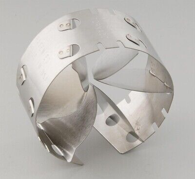

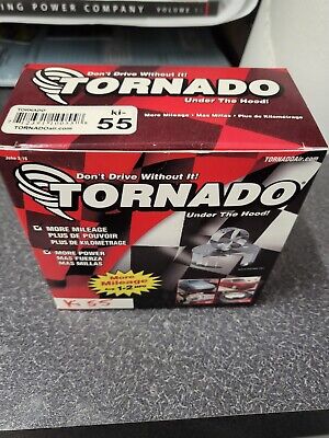

What a great Idea!
Beats the heck out of filling the Air Cleaner box with ice

Ok so yeah.. just read up on 'interchillers'..
Good lord do I love shit engineered for go-fasts 🤩
Everything about it. The idea... the ATTITUDE behind the idea...It's... it's just beautiful.
We need more Heavy Air
