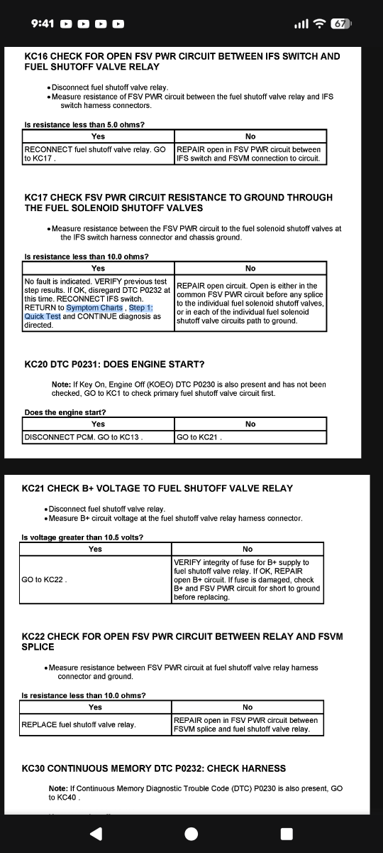

I'm pulling a KC20 code from a rather cheap Cen-tech OBD2 reader. Vehicle is a 96 Ranger, 5 speed manual.
I'm getting idiot lights for "check engine" and another one for "ABS". Not worried about the ABS, I'll take care of that eventually.
Recent work:
I recently fixed another code generated message having to do with the O2 Sensor. All I did was clean the sensor and re-install which took care of that; I just put a new O2 sensor in just in case.
I recently replaced a loose shifter with a manual shift rebuild kit.
I'm not finding anything on the KC20 code.
Any ideas?
