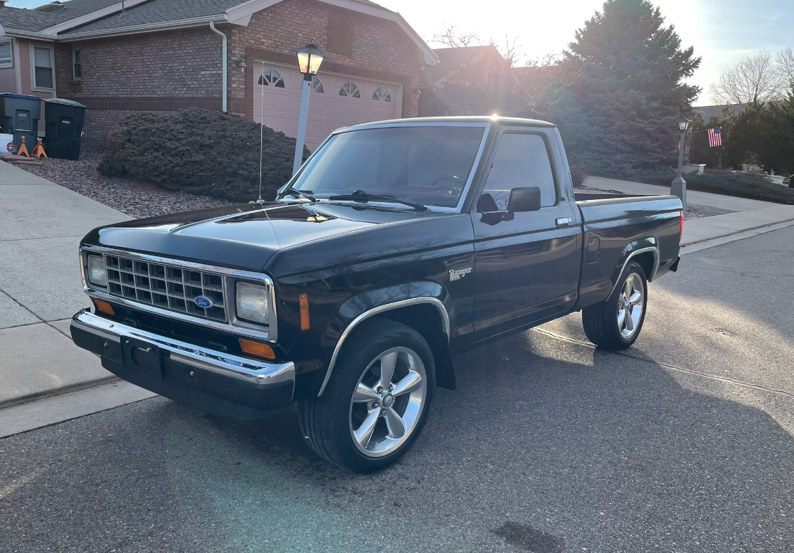

Howdy all. new to the forum here and also new to me is my 1986 ranger with 2.9. Here in Colorado I can register my truck as a classic and therefore emissions exempt. I am planning on new exhaust and removing the cats. My question is in regards to the 02 sensors. I know I need to leave the 2 upstream ones but what about the downstream? I am reading it wont hurt anything to disconnect but I wanted to ask the pros here before I dive into this project. Thanks so much and looking forward to learning a ton here.

PS: that's a really sweet ride!
