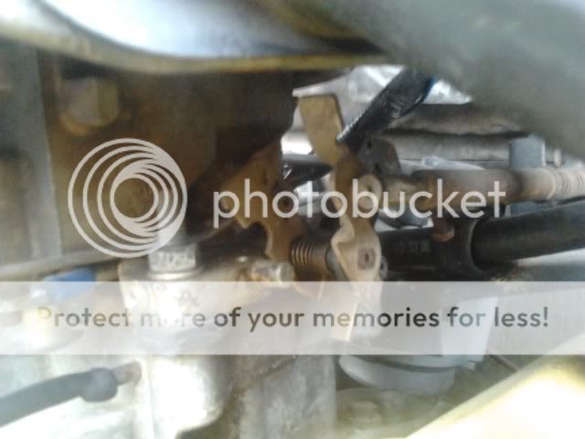

Anyways heres my current throttle linkage setup...what would you guys recommend I set it on? There are 4 slots to choose from, Im on the second one as you can see.

It numbers the slots 1,2,3,4 from the bottom to the top. For summer use it recommends slot 1 or 2. Also the other end of the rod should be in the INNER position (effectivley giving a shorter stoke)..this is the recommendation for a 260, 289 Ford and my carb.
I just changed my 2100 to slot 2, (I was on a road test and didn't have the ability to get the rod in the #1 slot, something I will take care of 2marrow). This will give me the leanest accel shot available for summer use..
From what you said, Im on a winter slot ,3, giving a rich shot and maybe using more fuel then needed.

The accel pump only reacts as you give throttle intially to enrichen the flow to transition from the idle circuit to the main jet circuit. It could run w/o the accl pump if your mains are correct, but does assist in extra fuel for the transition. it also helps when cold to enrichen for starting.
