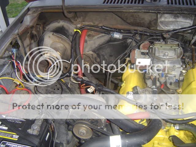

Heres my setup that I am running on mine.

Ya I think one of my biggest things killing me is the jet size being to big and the power valve not being hooked up.
Anybody have pictures of there setup showing where the power valve should be hooked up to and all of the other good things. Remember I am durasparked so keep that in mind.

does your carb have a power valve cover with "nipple connector" for a vacuum line?..older carbs had internal supply for vacuum. If your power valve cover as shown in the tech library 2150 rebuild pdf, doesn't have a place to connect a vacuum line yours may be fed internally. Most likely though it is external and there should be a vacuum source on the base of the carb for it..IIRC.. I'll have to check on a carb in the shop later.. I know KIMzzz will know..and other diagrams are available
I'll include a link to a GREAT source of info...
http://tekatlarge.net/Motorcraft-2150-2V-Internal-Carburetor-Systems.php
I'll include a quote
"in the case of internal vacuum passages, the power valve cover is simply a closed chamber that seals the power valve diaphragm and the internal vacuum passage on the bottom of the carburetor.
The external vacuum nipple must be connected to a manifold vacuum source with a hose. "
good reading actually..and for those of us who prefer pictures..or are textually challenged...this article has plenty of pics as well..
