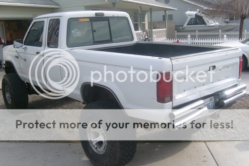

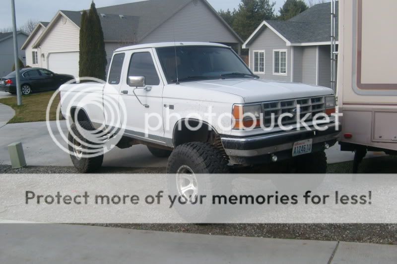

Well, I knew I wouldn't be out of the Ranger scene for too long. Went to look at a Ranger this morning and came home with this:
1992 Ford Ranger, 4.0L, FM146 (started its life with an A4LD, a manual was swapped in -- I'll put in a M5OD once this one lets go), manual t-case, three inch body lift, Rancho lift (drop brackets and springs). Nearly new 35x12.5x15 Toyo Mud Terrains (the main reason I bought the truck, brand new tires and wheels) with 15x10 Dick Cepek wheels. Drives great down the highway, held 70 no problem.
It has a stacked block in the rear :icon_surprised: so that will be getting changed out for some 63" Chevy leaf springs. Also will probably change the front springs out with some 6 or 8" lift Skyjacker springs so I can get rid of the coil spacer.

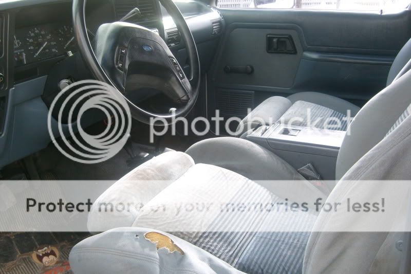

The driver's seat needs replaced (not a huge deal).

35's and 3.27's? is that the reason the a4ld died? looks like a good place to start from. good luck with it.
looks pretty decent...what did you give for it?
I'm sure 3.27s with the 4.0 didn't help the A4LD out any. And I gave up $3,500. I thought the price was fairly fair (the seller was asking $4,200), considering a stock 4.0 5 speed in this area goes for about $2,000.
It's definitely a great starting point, I can't wait to get started on it.
Well, I got rid of the window decals today and I fixed the driver's seat. I found a guy parting out a 94 Chevy 1500, so hopefully tomorrow I'll be picking up a set of leaf springs. I also found a set of Belltech 6400 shackles (slightly used) on eBay for $20..I'll try to grab those up come Monday when the auction ends.

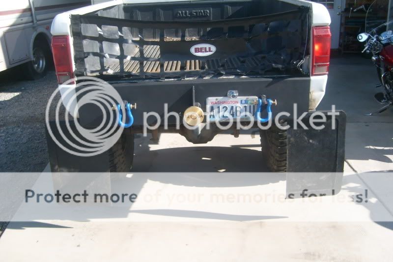

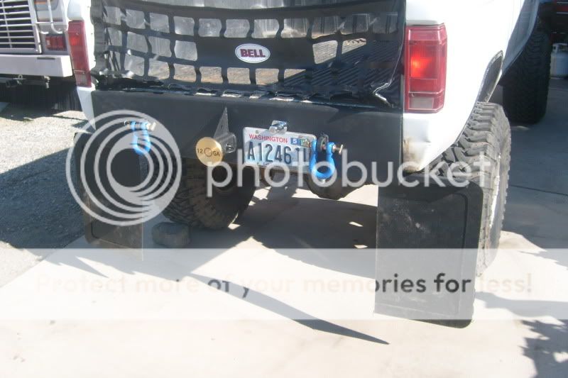

Been busy the past few days working on this:
The main boxed steel is 10"x3"x0.25". It was initially going to be the base for a bumper/tire carrier/tailgate, but I decided against the tire carrier (figured it'd be too heavy). So I ended up with this.
Hopefully before too long I'll get some new leaf springs ordered to replace one of the blocks. I think I'm going to go with 4" Explorer lift leaf springs. I heard they're a little stiff, but that would be alright since I'll be hauling hunting stuff come winter time.
wow cool truck man!! looks beasty
cant completely pass the mudflaps, but if u need em to be legal, its ok
Yeah I agree. I didn't want to put flaps either..but the cops are sticklers for it here. I'm still worried about the front...but I'm going to wait a little til I put some on the front.

Although I gotta say, that is the burliest roll pan I've ever seen. I like it :D
