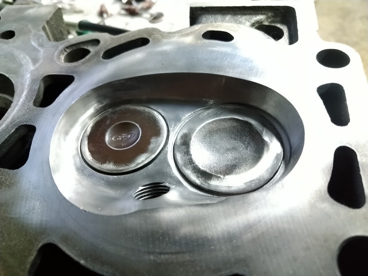

The 2.9 has serious potential. I'm building the proof of concept engine as I type this.
Old valves to protect the seats while working.
I won't put the 4.0 down too badly, but look at it this way. My 2.9 is getting the porting work while my 1994 4.0 is hanging on the engine stand
