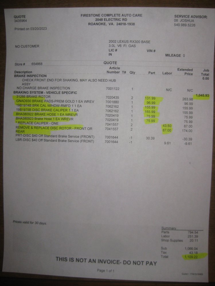

I'm going to a shop to talk to them first then of course they will say we have to see it but I thought I'd start there. I told other half it could be $500 (that'd probably be a decent price) or more and she says that barely pays a rental for a week so no-brainer, do it. She's like, then something else will break and I'm like, well, over a quarter million miles, yup, probably something will. On the other hand since her purchase price was zero, if it was me, I'd keep it going until something really major goes. Will update when I know more.
Yikes. look at these parts prices. Hose $75? RockAuto says $7. Etc. It's over $800 in parts and I was thinking at RockAuto maybe more like $200.
Labor is $250 which isn't too horrible but not cheap; if they would do it for just labor and I get parts that would be acceptable but they won't.
Looks like back to square one.
Edmunds says the car is worth like 1500.
I think that's the hit on miles. And that's assuming brakes were fixed (did not include brake problem in the appraisal). So your net if you have Firestone fix is then sell it is $500.
Something's not right or am I just running up against, this is old.
I can (1) tell her, that's the cost, do it (I have a hard time doing this because as I see it that's a total ripoff on parts) or (2) find a shop that'll take parts I supply or (3) tell her sell as-is to somebody who doesn't mind fixing it. Option of me doing it, I just don't see it, I have other projects, so let's say I got all the parts and did fix it and saved her $800. Would I "charge her" for labor? Highly unlikely. So there's nothing in it for me and potential downside I run into a problem with the thing half done (not sure what that would be, but seems like "simple" repairs often have a glitch in there somewhere). Yes it would be a nice thing for me to do it and if I were 30 probably I would but when you get older time gets more valuable.
Argh. So I need to find a guy I trust to do it, and how does that happen, I don't know. And then you have no warranty or anything on the work I imagine.
I could put an ad in C-list. Not sure where to go from here.
At least (it looks like) you didn't get charged for an "inspection" and the quote.
"MAY ALSO NEED HUB ASSY" means that you'll probably "need" one once they have it all apart.

The parts price doesn't seem crazy. Don't compare it RA and think you are getting ripped off. They got to buy the parts from a local parts house who has them in stock, not waiting three days for shipping.
Most shops mark up parts to help take care of some of the overhead. Pay the guy to answer the phone, call the parts house, make the quote, ect.
An independent shop is much more likely to take your parts, and do the install. Biggest thing, if there is a problem, and you buy the parts from them they will eat the labor on a comeback. If you bring the parts, you got to deal with the warranty on your own and pay for the labor to do twice.
Not that there should be anything that needs warranty on a brake job.
Even if you pay $1200 for brakes, spread out over 4/5 years until the next brake job, That's $20/25 a month. Hell of a lot cheaper then any car payment. It's seems laughable to consider scraping a car just because it needs a brake job.
