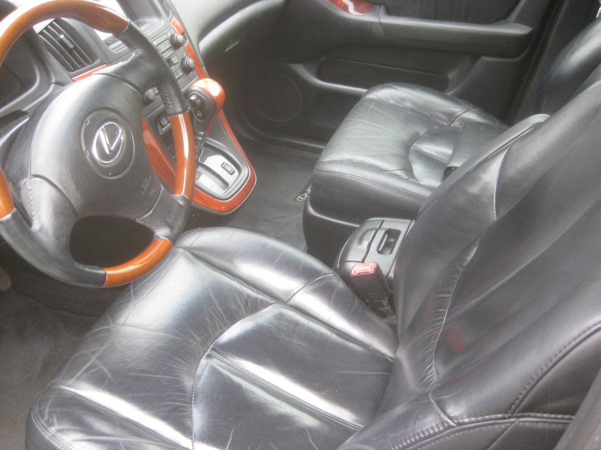

I vacuumed it out and used Meguiar's scratch remover which is basically like hand glaze maybe just a tiny bit more aggressive, it won't take out a deep scratch (how can you if it's down to the primer) but it does help a lot on minor stuff. Sometimes you find out it's not a scratch just paint transfer. Anyway, messed with it enough for now and she knows what it will need in the coming months/years (or at least some of it).

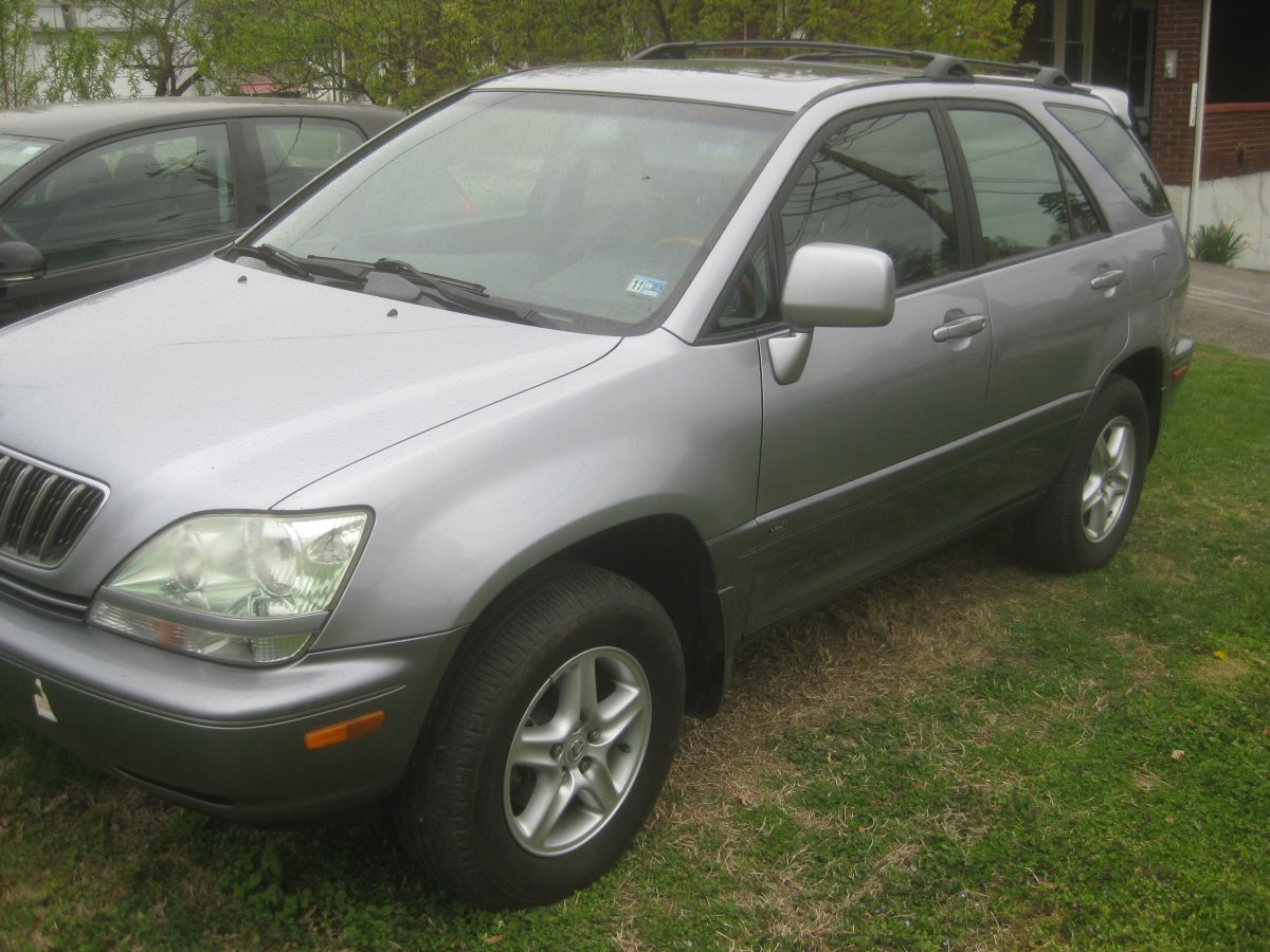

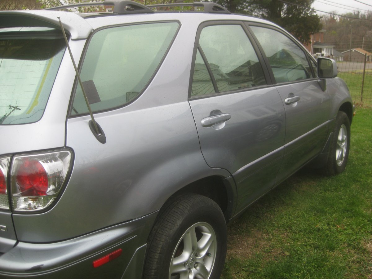

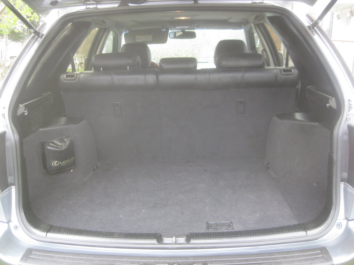

Doesn't look horrible, at 25 ft it looks real clean, closer up you do see some cosmetic issues but not crazy bad. I didn't quite finish stickers removal yet. Rear bumper stickers were covering a bad puncture hit, but looks like bumpers are cheap. She won't do it.... I would. These are quite huge inside, I could fit my big dog crate in the back. Looking for the missing bolts for the splash shield, thought they were common thread, seems not, about ready to go to junkyard for those. Edit: looks like scratch on hood in pic but it's reflection of telephone wire.
