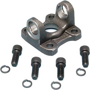

Nope... Flange off the t-case side of the rear driveshaft.
This piece here:

Note that you can grab the same parts from a 4.0L '90-'97 Ranger also, just in case whatever vehicle you found doesn't work out (is missing the parts you want, etc.).
