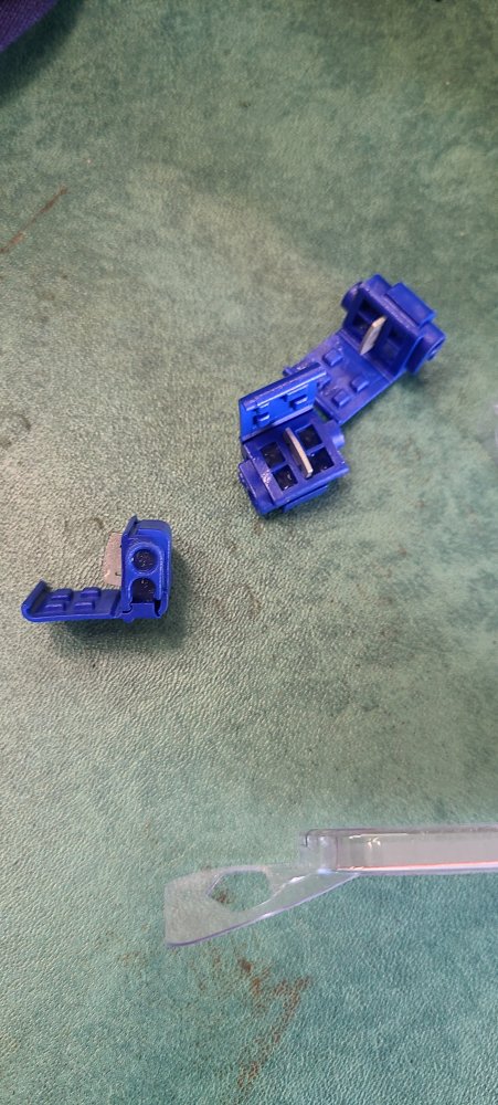

These things are absolutely horrible for making reliable electrical connections. They are absolutely wonderful at creating troubleshooting headaches.
