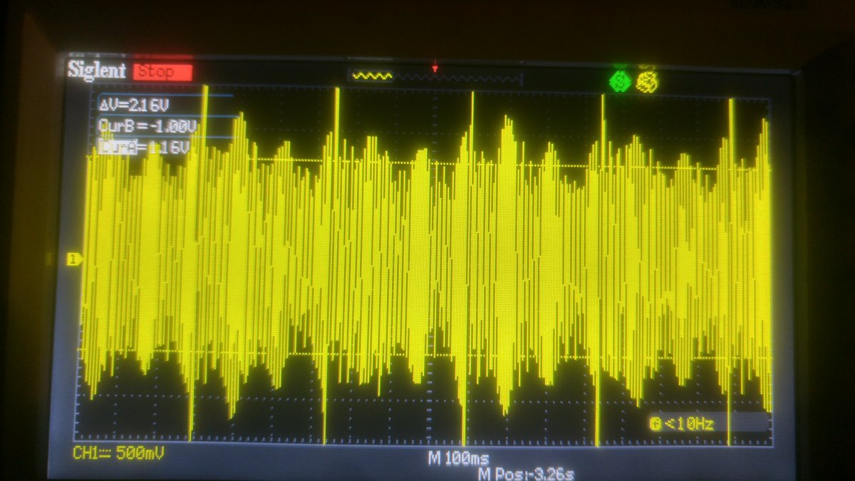

This is the crank position signal probed with everything plugged in by piercing the insulation. Seems strong enough at cranking speed. ~0.7vac is within book spec.

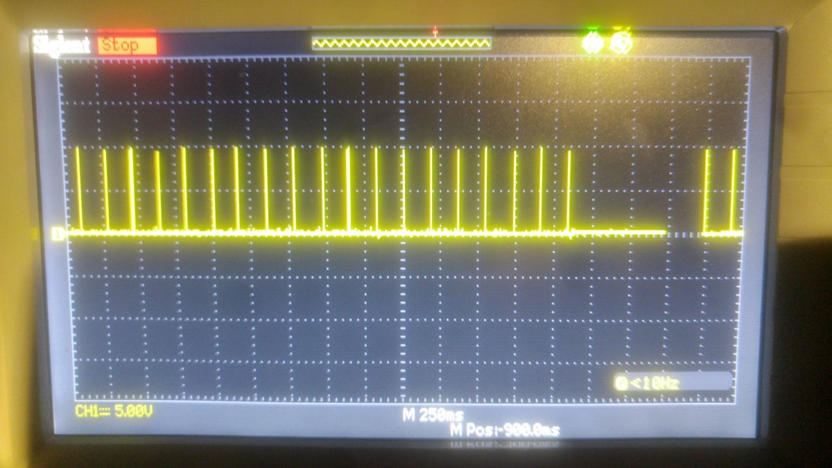

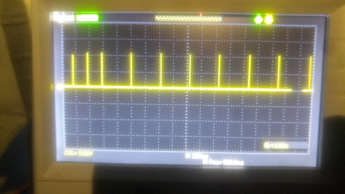

It gets a bit interesting when I probe the IDM line. Left is the PIP signal we know before. Falling edge indicates a coil being fired. Right is the IDM signal. Book says that this pulse happens once per engine revolution, but obviously it occurs once per ignition event. It also happens under cranking indefinitely. I do not understand why it can apparently understand the engine is rotating but not bother sparking.

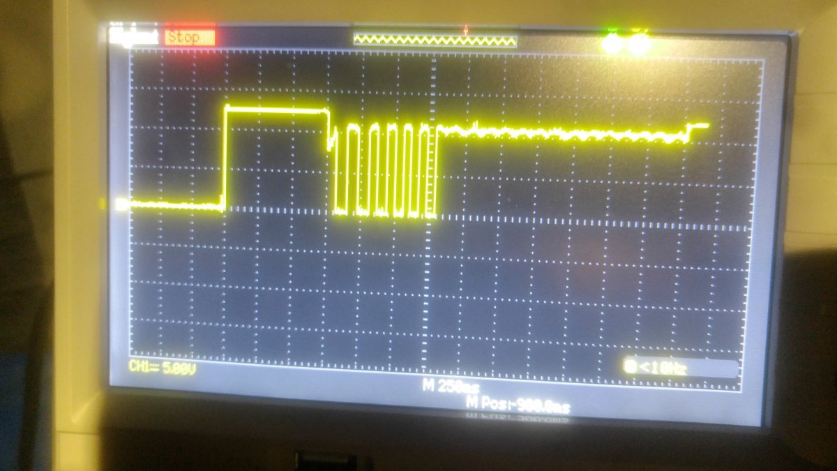

The strangest behavior of all is when the engine is not cranking. Key on, engine still gets a random IDM signal.
