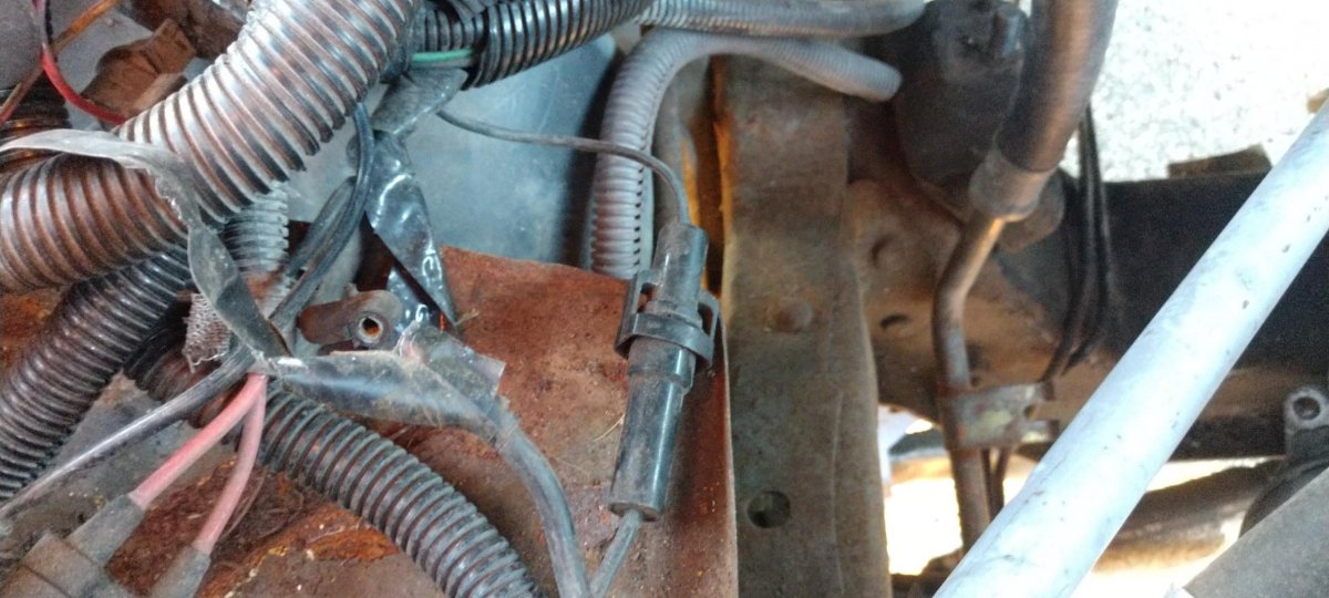

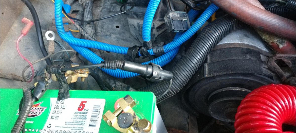

I unplugged an odd looking little black connector which comes off the battery negative lead to the bundle. I don't remember ever unplugging it before and now I think I should have left it ALONE!

WHAT IS THIS CONNECTOR:
I will post a pic of the little black harness plug I undid. I have been scouring the manual trying to learn what it does and how it could possibly have any affect on what is happening.

b) the little black ground wire connector is more that what it appears to be
After testing the wire for resistance/continuity it measure open. I separated the 2 halves and they both measure as good wires with near 0.0 Ohm resistance value but when connected it read open (infinite resistance).
It turns out that this little connector is a resettable circuit breaker. When separated it automatically switches to open and must be reset to function. I will show the parts and how they work if there is anyone else who hasn't experienced this issue or wants to see how this circuit breaker functions.
Needless to say, if YOU open this connector and put it back together without resetting it, YOUR ENGINE WILL NOT CRANK!!!
